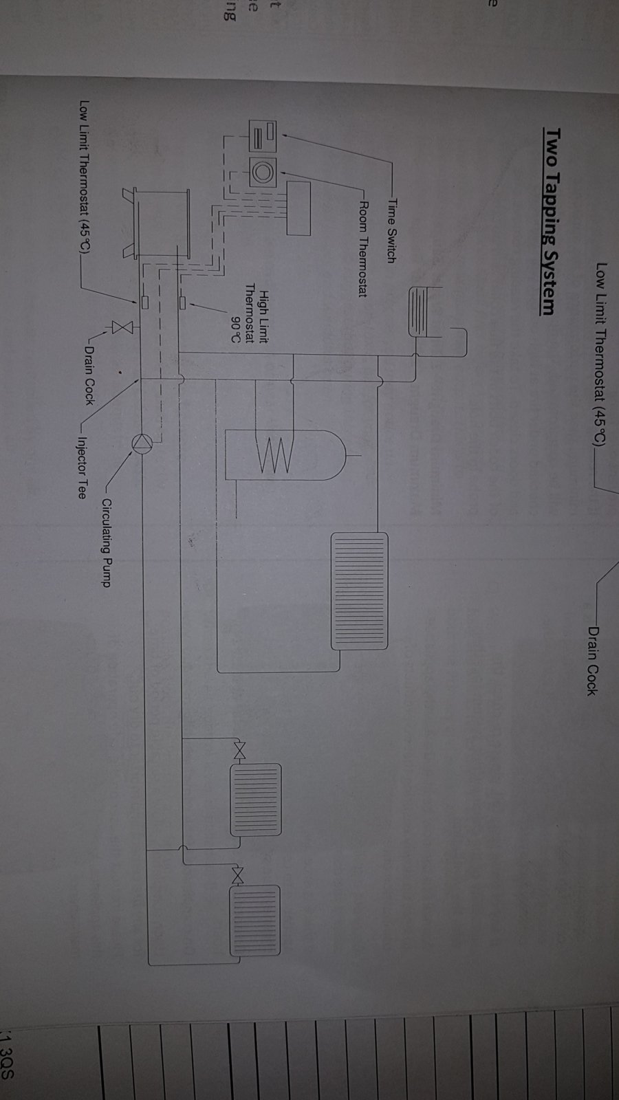

Not heard the mention of an injector tee. But see it here on the working diagram from Parker ray install instruction. Yes we are having a metal header tank installed snuggles.
¾" for the heat leak circuit - 22mm pipe and ideally a radiator with ¾" tappings, although ½" is acceptable with a maximum of 300mm of 15mm pipe running into it. Make sure you get high flow lockshield valves though, and it should ideally be piped TBOE. Pipework from the stove to the store should be 28mm. Your loft tank should have a copper float, as plastic ones can melt. An ESBE load unit is an alternative installation method

So leading on from that... I checked the wiring tonight. Looks like the thermostat near the bottom of the heat store controls the closed loop valve I guess to help heat the water quicker from boiler?
I see no other thermostat for boiler. My concern is when the Log burner is running what's telling my oil boiler to switch off registering that the heat store is hot enough.
I think my main concern here is our system 'seems' to be wired as a conventional boiler/rad circuit. Does anyone have any wiring examples of a Heastore/Boiler circuit so i can compare?
I have no diagrams, but if boiler is feeding heatstore, along with the wood burner, then a thermostat on the heatstore would control the boiler. If there is no interlock between the heatstore and the boiler, then the boiler will run on its own stat and cycle. What temperature is the heatstore loop stat set at compared to your boiler stat? A bit of experimenting with the boiler stat when the logburner is running may reduce boiler run time. Also do you only have 1 circulating pump through the boiler and heatstore, or do you have separate pumps for the boiler to heatstore, and the heatstore/radiator circuit?
Hi Oilhead i started to look at the wiring diagram, and reassuring you've said that. Initial glance of wiring i have the following observations:
Heat store stat is wired inline to one of the ZVA (Drayton Zone valves) therefore i assume it closes circuit when the heat store is below temp to bypass central loop and boost heat direct to heat store for hot water from boiler?
Room stat seems to switch feed from timer to switched live on boiler and CH pump?
There is only one pump which is on CH system which pushes.
Where would the boiler stat be set, we have an 18/25external worcestor bosch i gather you mean its a setting under the hood there?
Thermal store stat is set to 80 degress but as above only seems to activate loop.
Two crucial things you mentioned here i feel should be vital:
The boiler is not linked to heat store thermostat
There is no separate pump for CH when boiler is off not running, the pump on my system is powered from switched live on boiler.
