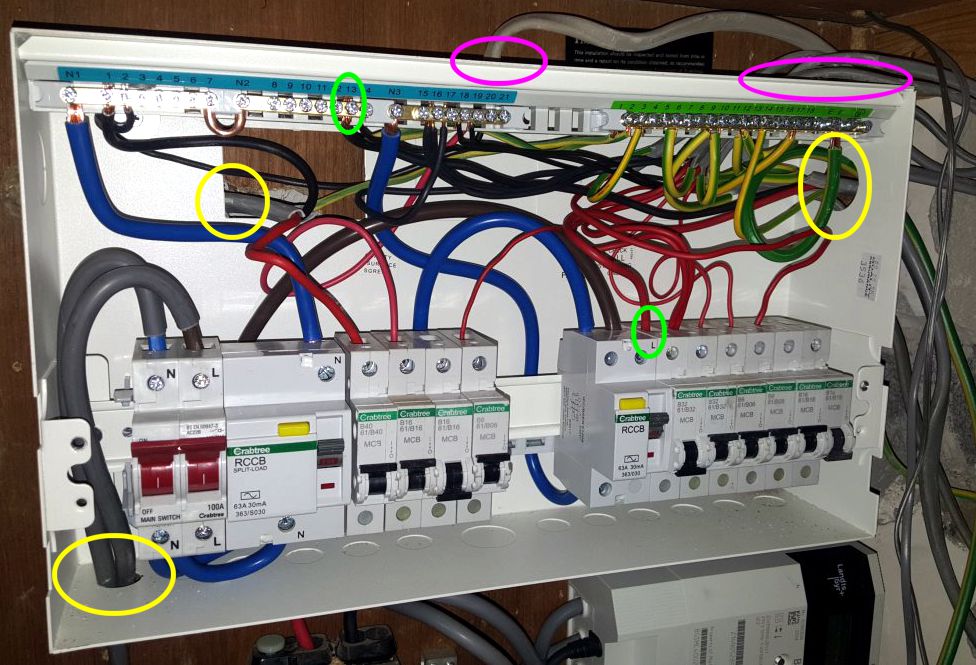

Problems after new consumer unit fitted

Well, I would point to 610.1:
Every installation shall, during erection and on completion before being put into service, be inspected and tested to verify, so far as is reasonably practicable, that the requirements of the regulations have been met.

Did he self-certify the work for Building Regulations compliance?
Did he notify it in advance?
Did he even give you an EIC?
Do you know who his employer is?

Doesn't matter whodunnit - the regs are quite clear that an inspection exercising reasonable skill and care is mandatory.
I did not ask what the regs require but, rather, whether it was common for electricians to undertake functional tests on every final circuit.
I don't know why you won't accept 610.1. It's all about carrying out I&T and it is plain that has not happened.
However, I think most sparks would go round and check circuits were working by switching a few things on.
Certainly, if it were a "borrowed neutral" scenario with the two circuits either one on each RCD or each on an RCBO, you would know about it when switching lights on, which I certainly have done as part of the testing procedure.

No it isn't.
Green - line and neutral of the same circuit connected to different RCDs.
Yellow - total lack of cable grommets/glands resulting in damage from the sharp metal edges
Pink - cables entering via the top surface, which given the state of the other entries will have no grommets and won't be sealed either.
Generally a very poor effort.
Looking at the yellow item, how would a domestic electrician correctly deal with that large rectangular cutout in the enclosure?
I work with factory 3 phase boards, sometimes old and much-altered ones, and I make sure everything is glanded and any holes covered, sometimes by fabricating my own gland plates and covers.
My own consumer unit at home, fitted over 30 years ago (metal) has these large openings at the back, and has plywood behind it. Cables enter through holes in the wood, positioned such that they cannot ever get near the edges of the metal cutout. This has always been adequate in my case - but I can see that it is not the case in the photo. Poor workmanship!
Not remove it in the first place if possible.
If unavoidable, there are flexible plastic strips which can be fixed over the sharp edges. Some consumer units are supplied with one.
