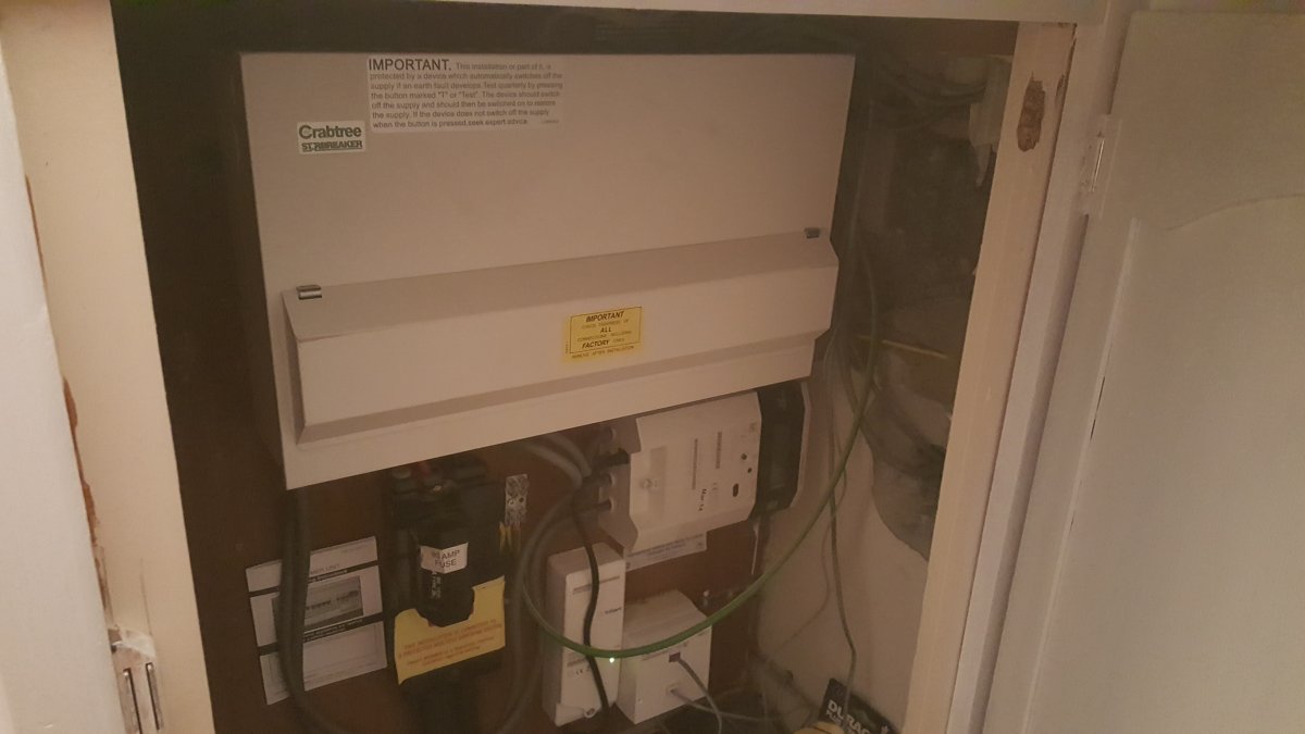

So just got home and checked the CU everything is wired up as it should. Could it be damage to the cable

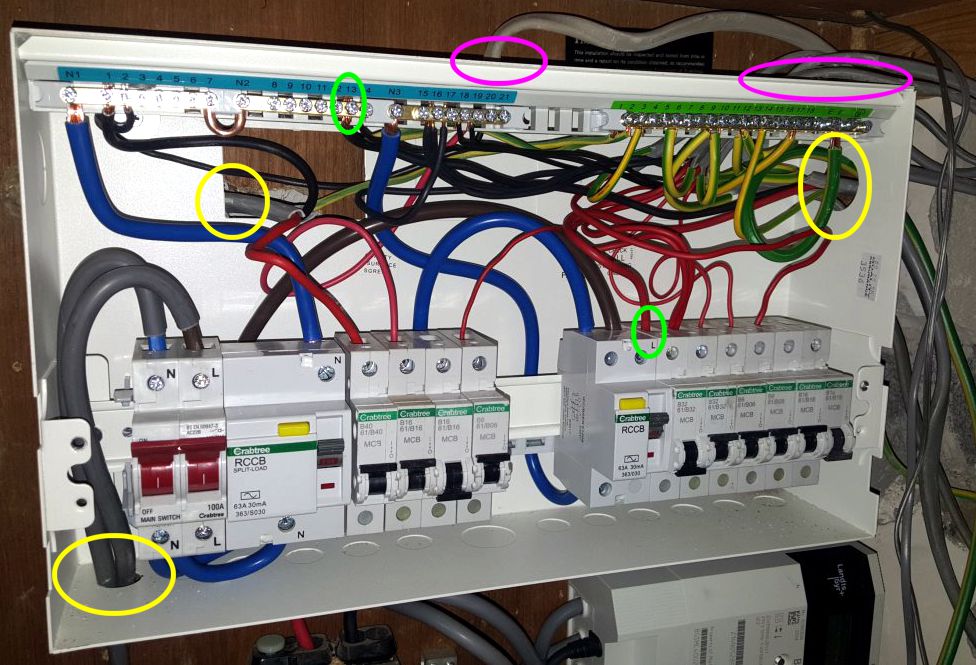

No it isn't.
Green - line and neutral of the same circuit connected to different RCDs.
Yellow - total lack of cable grommets/glands resulting in damage from the sharp metal edges
Pink - cables entering via the top surface, which given the state of the other entries will have no grommets and won't be sealed either.
Generally a very poor effort.
Wow that is a poor effort!
I don't see any main bonding either although that may be at the MET but i wouldn't bet on it.

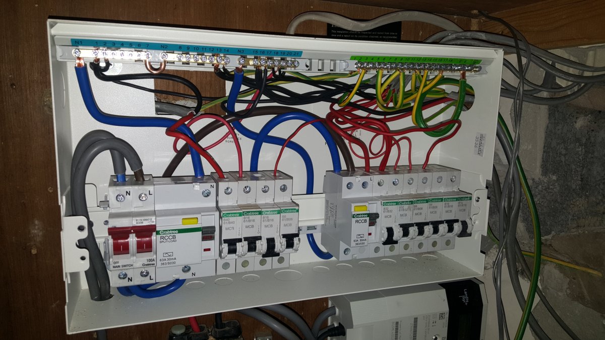

Can you take a zoomed out picture of a larger area?
Here you go
Would the green circles cause the trip

Here you go
Yes. Definitely. I can only assume he's not noticed the U shaped copper link linking the two neutral bars. That being said, there's no link between the middle and right bar so he would have been connecting them to nothing.
You appear to have two erroneous neutrals in your left neutral bar. There's 3 squeezed into two terminals on the far left, which account for the circuits on the left RCD. Then there's (presumably) your cooker/hob in #13 and a 1mm² in #14. Have you used all your lighting circuits etc since having the consumer unit changed?
