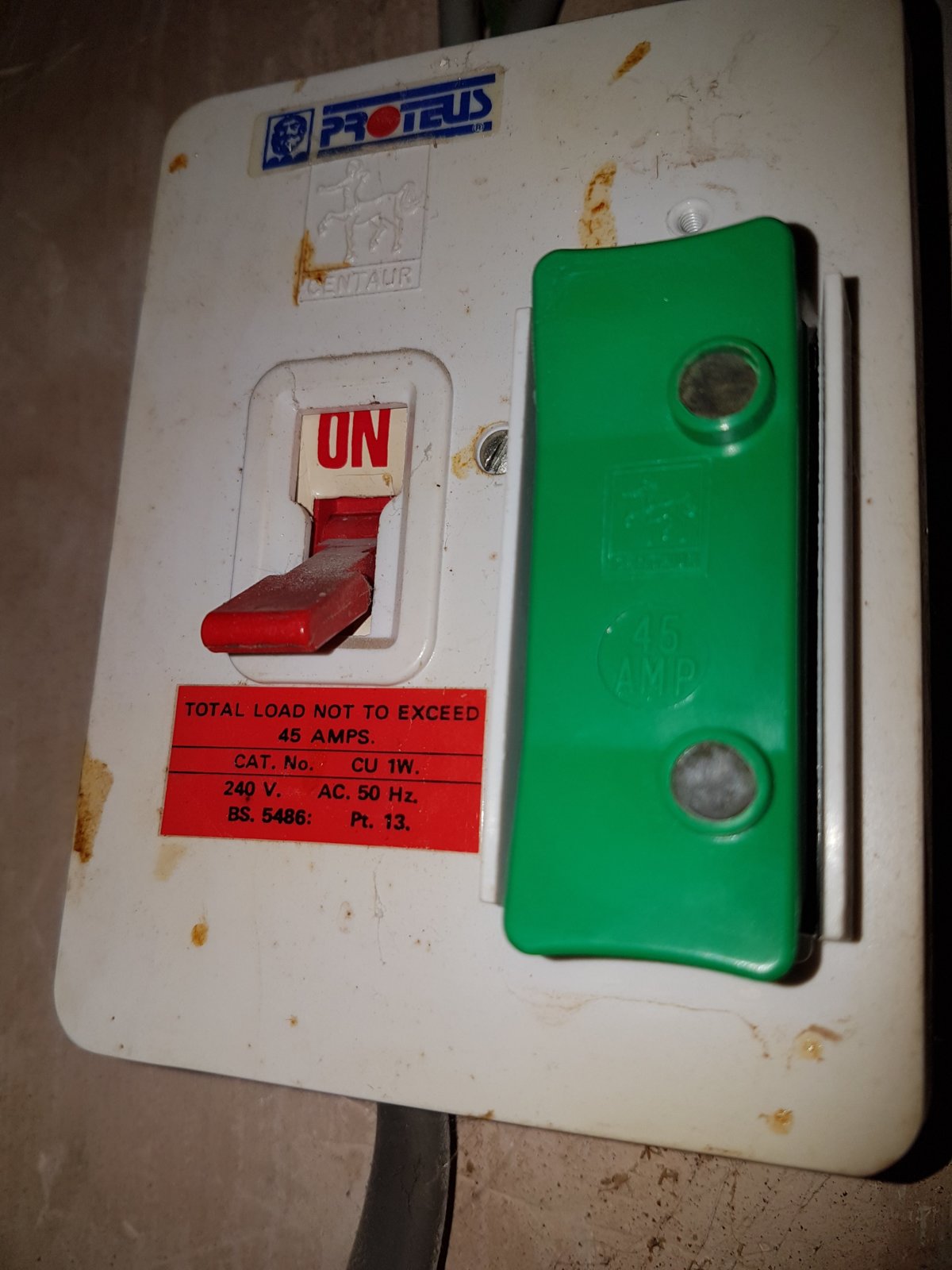

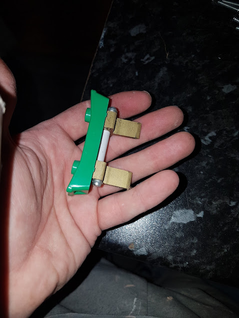

Can you still get these fuses . Need a 40 amp.

Not sure about the Proteus branded ones, but it appears from the photo to be a copy of the Wylex standard range, for which parts are still available. You'd need to double check for compatibility, but I suspect one of these would probably fit in it's place. (You'd need to change the green plastic base plate too)

I think Proteus , Wylex are same company as I needed a Wylex NB40 and a Proteus was compatible.
I need a 40 amp in this type though ?

Proteus is indeed the "own brand" of CEF, but possibly not the actual manufacturer.
What I was suggesting is that the unit in question was either made by, or under license from, Wylex. Just as the Sector branded CUs from WF Senate are re-branded Wylex units, the Acel branded ones from Electric Center are actually Schneider, etc. etc.
8.5 KW shower
In which case, unless you already have 30mA RCD protection for the shower outside of that unit, you should really replace* that unit with one that does include 30mA RCD protection. Then spare parts for that unit would cease to be an issue.
*Or rather have it replaced, as that would be notifiable work.
