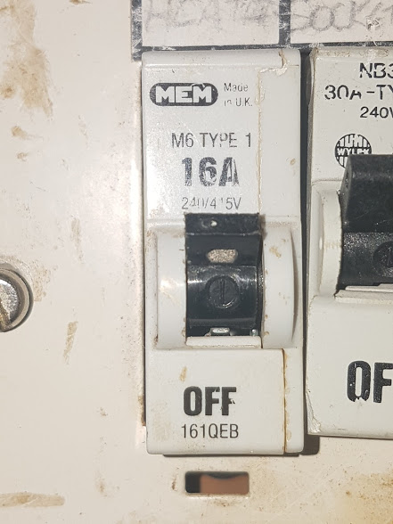

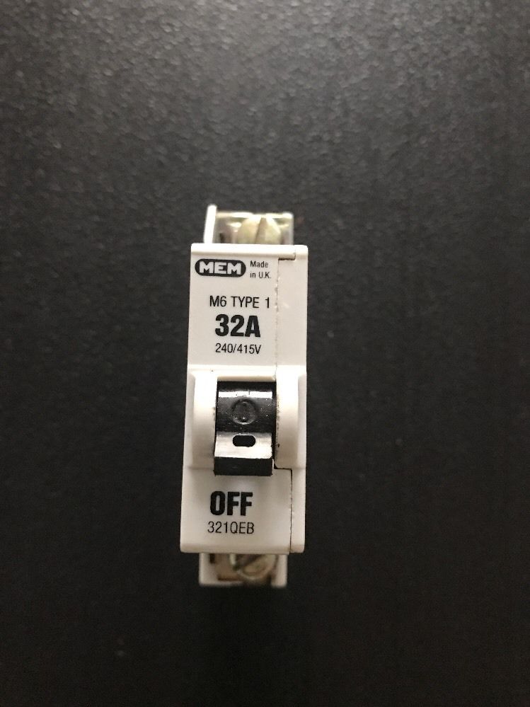

I need to purchase a Mem m6 type 1 32 amp fuse to replace the 16 amp. The 16 amp has 161 QEB on and the 32 amp has 321 QEB on. Does this matter ?
161QEB is the part number
16 for 16A and 1QEB for the range
32 for 32A and 1QEB for the range
I'd advise against replacing those MCBs. They are getting to the end of their usable life. My last flat had those in, came home to no lighting one day, assumed the MCB had tripped. Nope, the MCB had just failed with the dolly in the closed position.

Are you suggesting a consumer unit change ? You can buy them fuses still brand new ?
Where have you seen them new, they are now special order only and very expensive
The problem with old breakers like that on eBay is you don’t know what kind of life they’ve had.
It could be next to unused or it could have been totally abused and be really weak. There’s no way to know and there’s no way to test them.
True, that one claims to be "new, but without box and with some storage-related marks". If the seller is being honest, it's probably OK, but one can never know for sure.
I worry about whether you are competent to to this.
  • You don't know the difference between a fuse and an MCB (and this is not pointless pedantry - your terminology betokens a great lack of awareness).
  • You are replacing a 16A device with a 32A device, the 16A one has a model number 161 QEB and the 32A one is a 321 QEB, and you don't understand why.
What is the circuit? What investigations have you done to verify that you can safely uprate it to 32A?
Are you planning to apply for Building Regulations approval?
