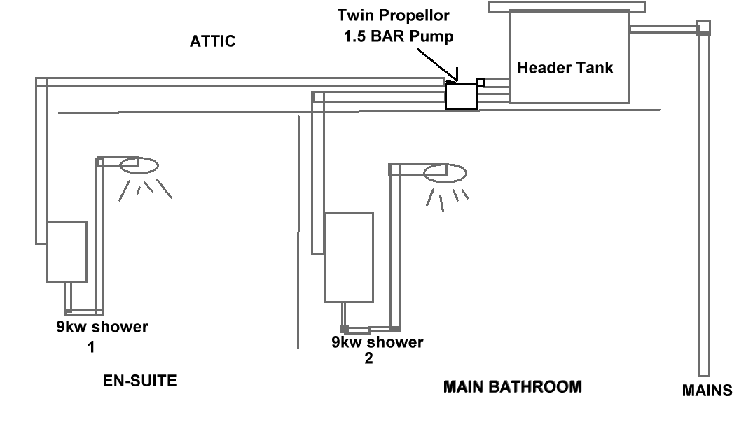

Pump at bottom of header tank in attic
17 Oct 2005
222
3
Ireland
is this do-able and will it work? - are pumps better to 'push out' the water or better to 'pull/suck' the water through?

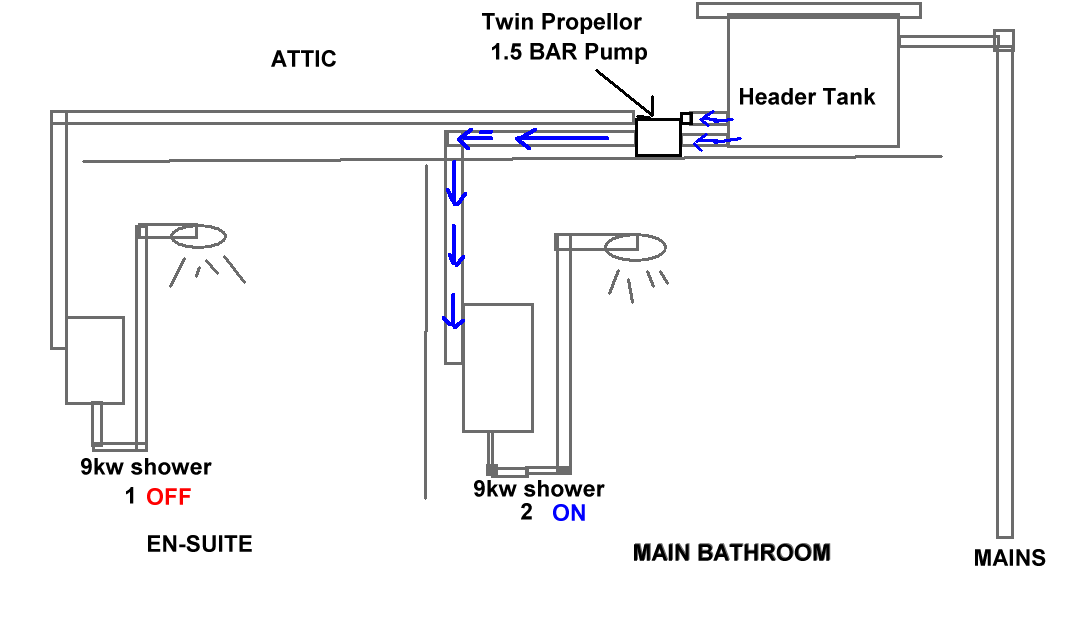

if you have your twin propellor pump with its 1 shaft running but 2 propellors are running but shower number 1 is not going but shower number 2 is operating would that (or the pressure but no-where to go) not ruin the propeller linked up to shower 1 ?
Or would i need to fit 2 separate single propellor pumps instead of 1 twin propellor pump at the bottom of the header tank to work it?
many thanks.
Andy.

Something I have been asked - not sure ....as "pumping against nothing" of one impeller will only be short term . ?
yes I am wondering. - if you stopped both propellors but turned the pump on then you would/could burn the pump motor out but what about if you had 2 showers , 2 propellors on 1 motor shaft (twin outlet single pump) and one shower was not running then one side of the propellers would be still while the other side the propellors will be moving boosting the pressure of water to the shower that is running/working
A pump into a pump probably isnt going to achieve a lot.
Have you checked the shower units for any filters that need cleaning/replacing? Are the shower heads clean or scaled-up?
I had no idea that pumped flash heating showers existed so apologies for that.
You'll get a much better shower from the hot water cylinder than you ever will from the flash heaters. Yes you can fit pumps to the output of a cylinder- you might need a specialised flange to prevent air being sucked in.
The pump from the header tank- try it if you want. It would be highly possible to tee off the pump outputs a pair of returns into the header tank (fit with adjustable pressure relief valves, set them by trial and error, make sure they can adjust down to below the max output pressure of the pump).

could change them for immersion fed non instantaneous pumped but along with buying new showers then i would have to plumb in extra pipes from the immersion tank cylinder to the showers that will be awkward and messy.
Be handy to try the pump at the bottom of the header tank (more room to move) or stick a pump (or 2) in the airing cupboard but its a bit tighter space there where the pipes are.

Re your query of burning out a booster pump, very unlikely but you might damage the pump seals, unlikely in a cold only twin pump, (which doesn't make sense anyhow, you would install a single impeller pump with sufficient capacity to serve both showers), the question is often posed where a "twin" pump (whole house) suppying both hot & cold is running for prolonged periods using only say the cold to wash a car or whatever, Stuart Turner, I think , say that its not a problem for their brass bodied pumps but I wouldn't care to put it to the test.

So, a test of taking front cover off the shower, undo the compression joint and run the water into a bucket and measure the amount of litres per minute the water is flowing from the pipe from the header tank then look at the spec's for the shower of required minimum input and check that it meets that?
also, showers have in their spec's minimum BAR for them to work properly , how would i be able to measure the BAR pressure of the pipe going into the shower unit effectively as well as the litres per minute?
I cannot be 100% sure but rather than anything blocking the pipes from the header tank I still think there is not a good enough head of water coming from the header tank personally myself and seeing as its a bungalow and that the header tank is up in the attic above the main bathroom that it just hasnt the pressure / enough pressure for the input required for the showers . i could be wrong though.
What size pipe feeds the showers? Pressure and flow rate are two different things.
If you don't have much head pressure (ie not much fall between the tank and the outlet) you can compensate by having a larger bore pipe so that you have better flow for the same head pressure.
Do the simple test first, just turn the temperature setting to its coldest, start the shower and then just hold the bucket under the showerhead as is and measure it.
