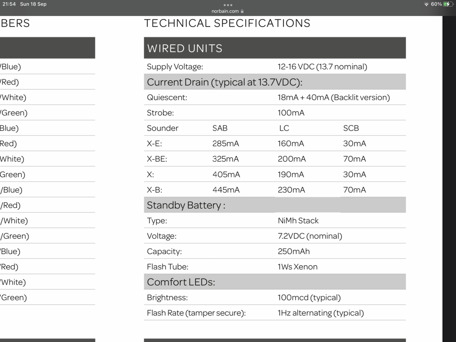

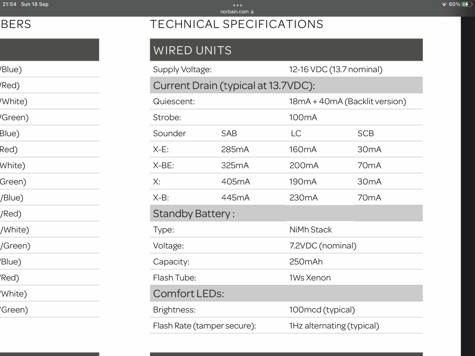

Hi All,
Thank you for your time. We're moving into a new home in 2-3 months time and wondering the best way to secure it as we are strangers to the area. We had a burglary at our current house but at the time, we had no alarm system or insurance.
Can I ask if it is possible to wire a texecom odyssey x3 (with lightbox) with a Pyronix Enforcer v10? I believe there is a max current limit the v10 supports for the bell.
I would ask the installers to use the normal Deltabell X with lightbox but I'm worried if I have two of the same bell boxes front and back, somebody may find what kind of system I have. I also think the Deltabell-WE which I currently have is very quiet.
Would it be possible to have an internal siren also in addition to the main boxes as I find the internal siren of the alarm panel is also very quiet?
Thanks,
SomethingSomething
Hi Sparky, thank you for your message, we will be taking our existing v10 wireless to the new property. Would it support the oddesey light box version on at nighttime with backlit light?
depends on how you use it.
Enforcer will tell you in manual what it can support.
The texecom manual it will tell you the power it uses on its various modes.
Of top of my head the mmm mmm it won’t won’t support it in full alarm on full volume ie SAB mode with back light.
Thanks all, Deltabell X it is then! I believe the wired should be somewhat louder than my current bellbox, as it will be have two piezos. Really appreciate your help for free and so promptly. Is it reccomended to have the alarm installer's logo on the box or should I say to leave it blank?
Or use it in low current mode …..

Thanks Sparky! if only I could have two deltabell x's wired to the enforcer v10.... one can dream......
