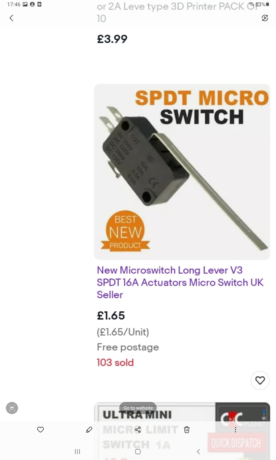

My alarm panel keeps triggering for tamper on the sounder. It's been fine for years. I went up recently and replaced the battery (as this also recently began to warn). Battery warn for sounder is gone but tamper remains. I tried checking the pcb and housing was nicely seated inside the outer casing, and the cover shuts properly but still a tamper.

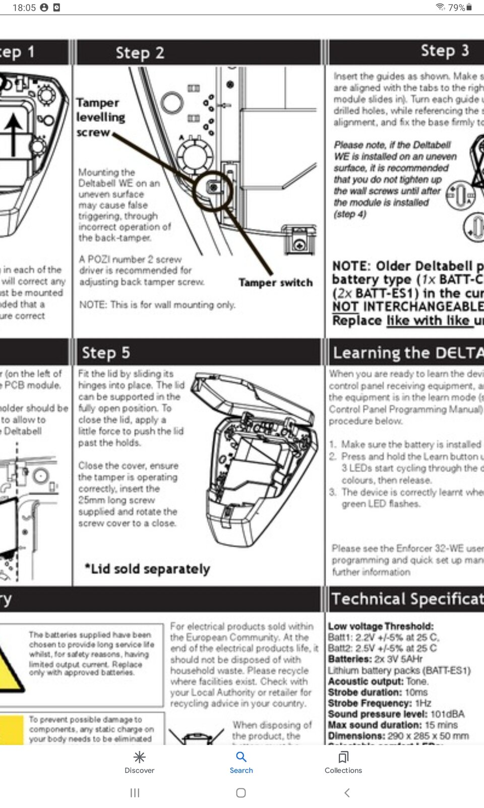

How many tamper points are there for this sounder? Just the one that detects the front cover being lifted, or others? If it is just the front tamper, could it be faulty? Can the tamper be replaced, or before that is there a way to adjust the tamper?

Tampers can be replaced. Potential you’ve inadvertently broken the bell box cover one if you weren’t sure what you were doing they are very sensitive. There’s also a screw one that senses whether it’s being pulled away from the fascia of the building
Afew years back Pyronix had faulty batch of bell box microswitches. These can be replaced.
How old is your bell box.

If the clear pcb slides up then the retaining screw has NOT been fitted ! There is a small hole near the terminals which should have a screw in it …as been said before it’s probably the tamper switch , if it’s a green one then definitely replace it …

Where is the screw for sensing the device being pulled away from the wall so I can check that too.

4, probably 5 years since the siren was installed. Not sure of manufacture date. etc
This looks like the same one from your photo - microswitch or I see @sparkymarka has recommended this one in another post - microswitch.

If I recall, the microswitch is grey in colour. Either way, for the price of a few quid, it's worth replacing. I did read online that overtime the 'screw for the tamper needs adjusting'. I assume that means there is a screw holding the front tamper in position?
I'll try and screw in the PCB housing to the casing too since that has been missed.
Microswitch could be in the faulty period.
For what a switch costs would recommend replacement.
You can also adjust the lever to get a better closed connection. Screenshot_20220925-180529_Google.jpg
Post picture of inside of bellbox….I have seen on here the screw for the back tamper not been fitted !
