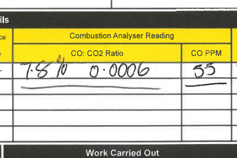

- If the gas meter had not been working (ie the display was blank due to a fault) on the date the inspection/service was purportedly done, would it have been possible for the information shown in the attached image to be available - it has been suggested not in the format shown, if at all.
That figure has absolutely nothing to do with the gas meter, as for the flue yes it could be ticked yes but a AR advice notice should have been issued for the flue not being sealed to the fabric of the building and noted on the CP12 Gas safety Record

By my calculation, if the Co & Co2 figures are correct, the ratio is 0.0007.

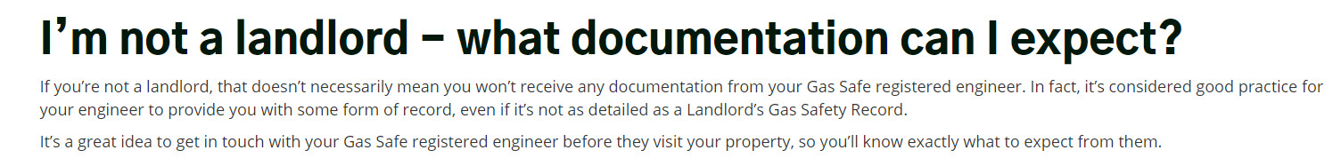

I have just found the information shown in the attached on the Gas Safe site.
The implication is that for residential homeowners (not landlords or tenants) there is nor regulation governing the issue of a safety certificate when either installing or servicing gas equipment - is this correct?
