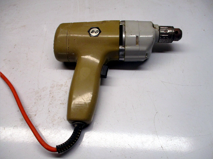

At least in my opinion, it was neither a hypothetical or a silly question. As I said, the situation is nearly always that of protecting people from live electrical parts within some item and, as EFLI has said, the approach of non-earthed (even if metal-cased) and double-insulated is then generally favoured. However, as I've said, I think that things like corded drills are a very special case since, fairly uniquely, they then come with a risk of 'becoming live' as a result in coming into contact with live parts outside of the item (in addition to the usual risks associated with anything which has live parts 'within it').
So, although it doesn't seem that EFLI agrees, if I thought that there was the slightest risk that I could drill into a live cable (which is a possibility I would obviously seek to avoid), in the specific case of a drill (or similar) I would personally be happier if any touchable metal parts (including chuck) were earthed (whether or not it was also 'double insulated' - and that would even remain the case if there was no RCD protection, since an MCB or fuse should normally respond to such a live-earth fault.
Like you, I do still have some (working, but very rarely used these days) drills of this type, like the one illustrated below - metal bodied, 'double insulated' and not earthed, with very low resistance between chuck and touchable metal parts of the body.
Of course, even if the body of a non-earthed metal-bodied drill becomes 'live' that, alone, will not result in an electric shock. For a shock to happen in that situation requires that one is simultaneously touching something else which IS earthed. That's why, as EFLI has said, it is, in general, undesirable to ('unnecessarily') earth metal-bodied double-insulated items - since if one touches one of them at the same time as touching, say, a 'live' drill body, one would get an electric shock that would probably not have happened in the absence of that ('unnecessary') earthing of the second item.
