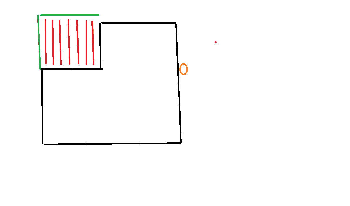

Hi All
I live in a semi, and we have a patio at the back of the house, what I noticed is that the part of the roof sloping backwards has downpipes connected to the patio roof. I also have another downpipe which meets the downpipe of the patio on the surface of the garden, when I lifted up some of the patio boards, I noticed there is no gully under the patio as such, and the rain water is simply left to pour on the garden where the patio ends.
I am not sure if this is right, we have been living here for just over a year and I have not really taken time to check how it all links. The nearest drain/gully is at the other side of the house, so to get to it, a pipe will need to run the whole width of the house, then directed towards the side of the building which is where the nearest gully is.

Yes you are right, I meant decking. Sorry about the confusion. I have put together a small diagram here.
The red lines are the decking.
The Green lines are the existing roof gutter, the one to the left is the one carrying water from the main house, this pipe is under the decking, the green line in front of the decking is the decking area roofing, they both meet by a corner, and that corner is where the garden starts from.
The orange circle is my exising gully or drain which waste water currently goes into.

Roof water usually discharges into guttering and guttering takes the flow to a RWP over a gulley.
Have you had a careful inspection round your house to look for a perhaps overgrown or covered gulley? Esp. below the patio down pipes.
Are you saying that you only have one gulley for the whole house?
Where is your manhole located?
Perhaps a photo of the rear elevation would help?
Waste water gulley may just be that, for waste water. Rainwater may have its own drainage system, go to a soakaway, or its not impossible the downpipe has never been connected to anything, instead discharging onto the floor. What age is the property, and what arrangements are there for rainwater elsewhere on yours and/or the neighbours properties?
