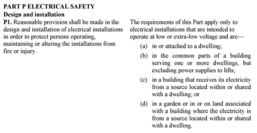

I am sure I have seen "complies with the Low Voltage Directive" on instructions for consumer products, but I can't find any proof.
However, if practices/laws ever altered such that that did not remain the case, then there would, in my opinion, be such a potentially dangerous situation that I think something would 'have to be done'.

Although I can't say that I've noticed that, you may well have done (and a CE mark obviously implies that). However, I doubt that many people would notice, or understand what such a statement means, and, if it does happen, I would suggest that it would be far less worrying (and far less potentially confusing) than would be the case if something were described as a "Low Voltage toaster", "Low Voltage oven", "Low voltage lamp", "Low Voltage toy" or whatever.
I don't think that Part P is particularly relevant. It is probably inevitable that it be written in terms of the 'official' definitions, and anyone who needs to read it will hopefully understand what those definitions are.
