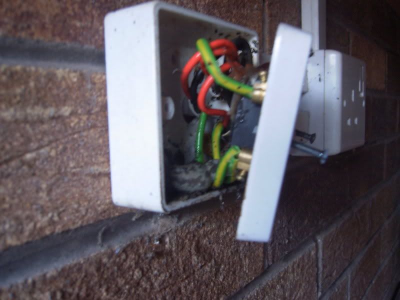

Unfortunately, I have not managed to glean any new pictures of interesting electrical installations. So, for my second and final week sitting in the POW! hotseat, I am posting a picture of a situation I came across a good while ago.
NOw the pic quality aint that great but.....................
It looks as if there has been some burning / arcing going off
And laying down on top of that bottom cpc is it a slug or a snail.
Lovely pointing on the wall BTW :lol:
THoes slugs are right buggers, they get in via the smallest of holes/cracks.
I hope you launched it into outer space...
As you can see, the socket is a stadard fitting in a rather damp shed built onto the back of a garage.
The pattress had 5 or 6 slugs living in it, along with loads of slime & slug sh*t.
That's what was tripping the RCD....

That reminds me of an alarm engineer I know.
He was cauled out to a fault on a system. It kept going off or something.
Anyway, he turned up on site and went to the main panel. On removing the cover, he was greeted by a mouse nesting on the nice warm transformer :shock:
I'm sure Lectrician will post his photo of a mouse in a panel board shortly...
Hey,
Got called out to a faulty cooker a while ago that tripped the MCB and RCD, disconnected the cooker resumed the power and stripped it down to find a dead mouse across the Live, Netrual and Earth terminals of the incoming 6mm^2 supply. I do have photos but cannot put my hands on them as it was a while ago.
