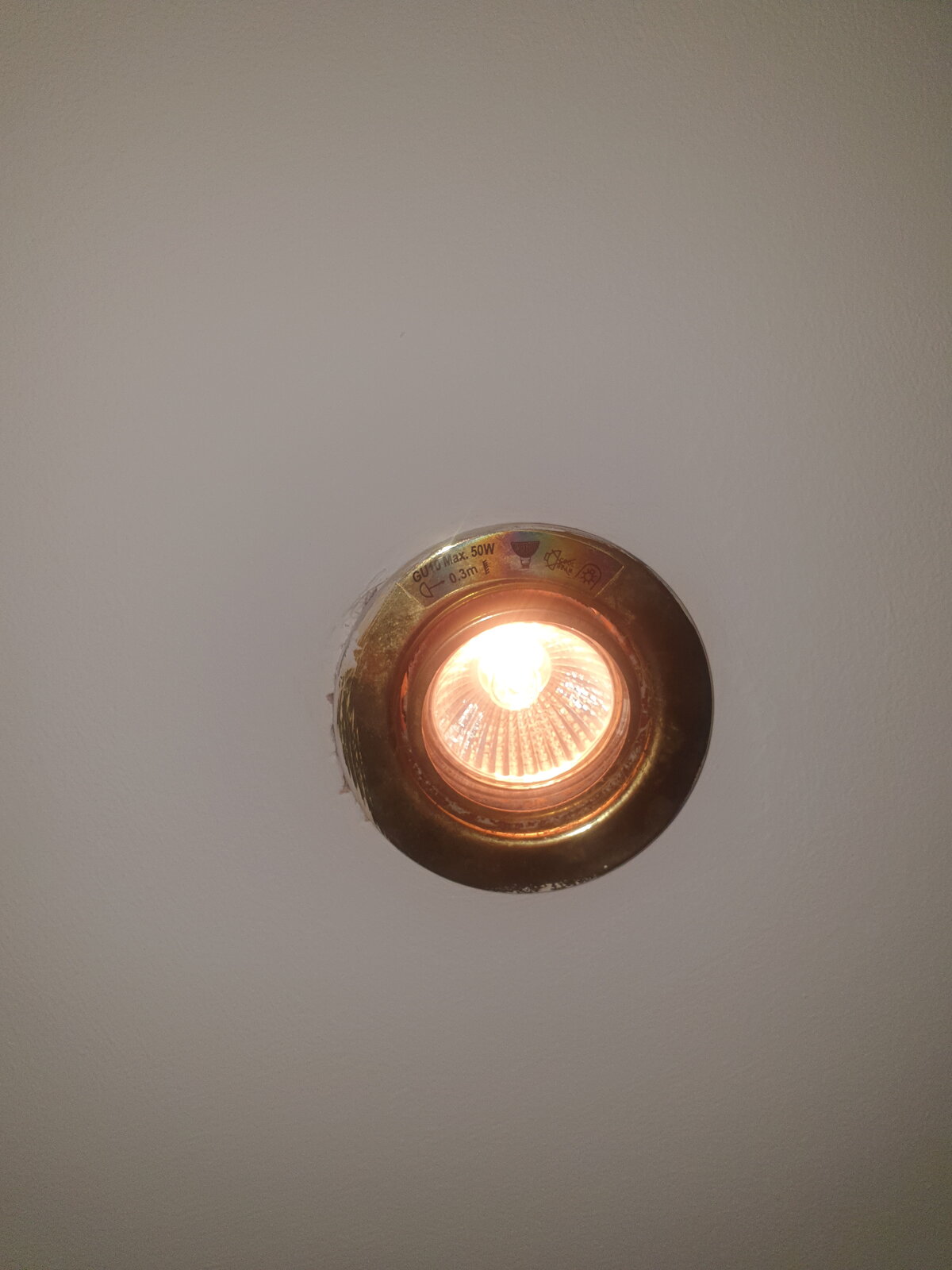

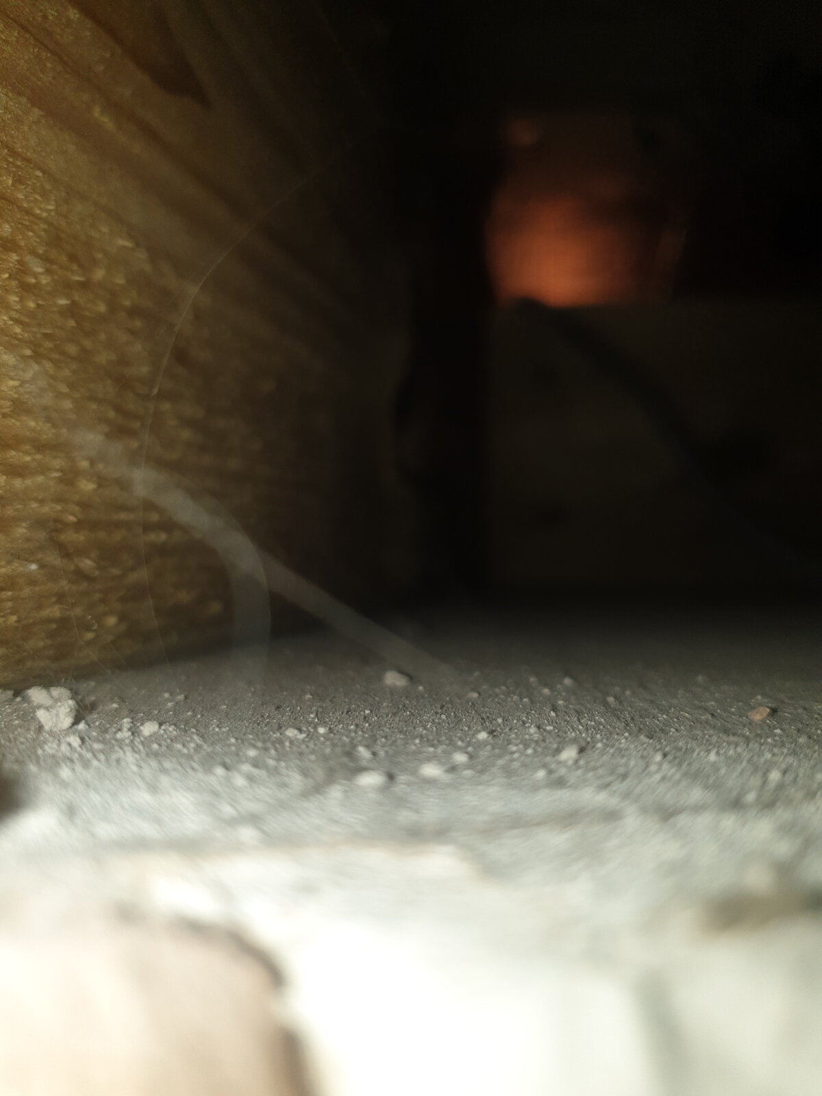

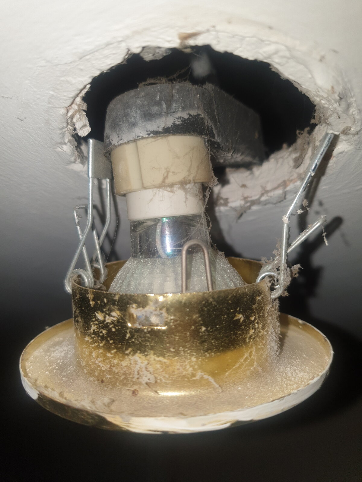

Hi ive been having bad Allergies and have just discovered dust is coming in from the ceiling it is coming in between gaps in the recess lights in ceiling (I live in top floor flat) . Took a couple of photos, I pulled one light down. Seems very old. Is this how you install a ceiling light? It looks bad to me and the board just flakes off and filters into the room around edges where light does not fit hole. Is this dangerous? I put my camera up and took a photo of the ceiling and it is dusty so all this dust is coming down though the gaps where the lights are not sealed 100%. I'm renting so need to know what to say to landlord. Any help appreciated.
Thanks.
As unbelievable as it sounds, what you have is quite normal and acceptable.
Downlights are a terrible design, especially when it comes to the time when you need to remove the entire fitting and the edges of the hole begin to crumble.
I really thought by now they would have designed a special ring to fit round the hole to allow the rest of the fitting to be removed.
You could get your landlord to replace the fittings for more enclosed ones, with a GU10 LED lamp. LED is far more efficient, the bulbs you have are old hat now.
Alternatively you could have new integrated LED fittings where there is no bulb to change, but these don't last forever.

The lights swivel and can be angled which I think is bad as it leaves gaps for dust I would not think this is ideal for ceiling.you can see in the photo I took dust around the inside of the light so even if edges are dust tight dust will come down.
Also when I moved into the flat many of the bulbs were blown and I had to replace them which was not easy. I had to unscrew the light, pulling it down. (like in the first photo I sent) undo the mechanism. Replace the bulb. Put it back together then using the clips push it back up into the ceiling. (with dust from edges crumbling) and after multiple attempts getting them to stay up.
I think by doing this maybe I left gaps that weren't there before that have contributed to the dust and in hindsight should not have attempted it myself.

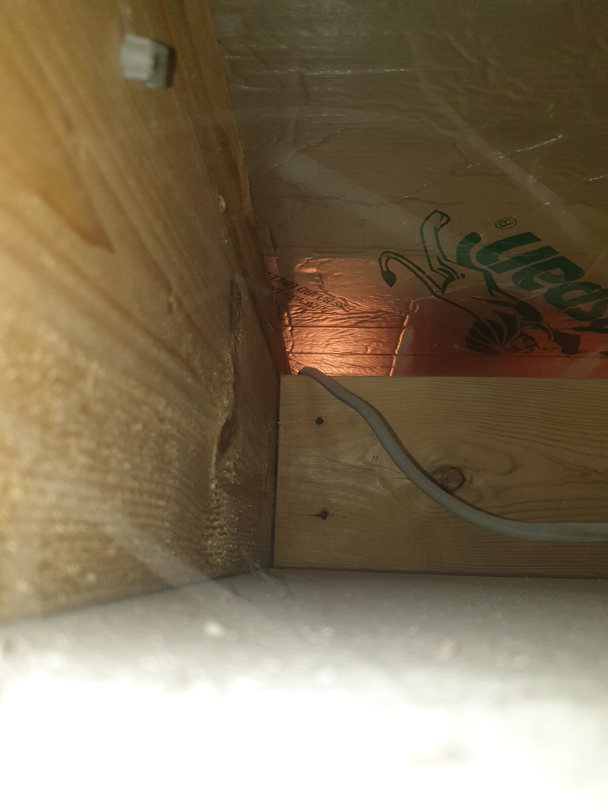

Unrelated to electric but looking at the photo of the ceiling there is no insulation on the ceiling top just dust. Long shot but I wonder if anyone can tell me if this is normal or not. Maybe another forum is better. Hygrometer showing 65% or so which is bad.

Having an uninsulated loft is shocking.
You can get fire-resistant hoods to put over downights, but if you are at all handy you can make an open-ended box out of plasterboard and put over them (plasterboard is a fire barrier)
You can snap it to size with basic tools, and although you could nail it together or make a wooden frame, I think it would be sufficient to glue the pieces together with builders adhesive.
Hoover out the dust immediately before fitting.
Insulation can go over the covers.
Avoid the old yellow fibreglass which sheds irritant dust and fibres. You can get brown mineral wool treated with Ecose to prevent it. It is made by Knauf but widely sold as an own brand. Ecose is marked on the wrapper.
Having an uninsulated loft would be shocking if true. But is it?
Here is another pic I took with more light. Looking again there is insulation called "Kingspan" against the top of the roof rafters but nothing on the flat part above the ceiling. So I guess you could say partially insulated. It is pointed out in epc it is very poor. But still can get D rating.

They also make over-sized down lights which are designed for larger holes in ceilings.
They won't help with dust getting through where the bulb goes, but they are big enough to sufficiently bridge the gap between the edge of the hole and edge of the fitting, as it will overlap a few inches.
You need to talk to your landlord. Forget covering the lights - it's dangerous.
