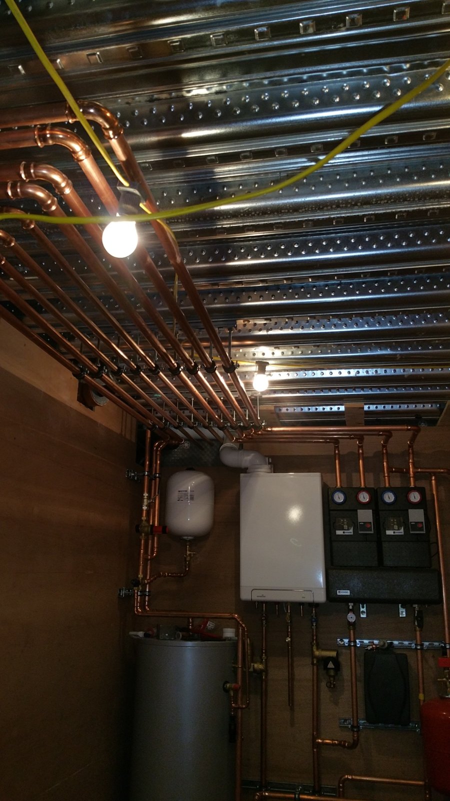

But seeing as you asked nicely... here is one I did earlier:
Not quite finished there obvs.
