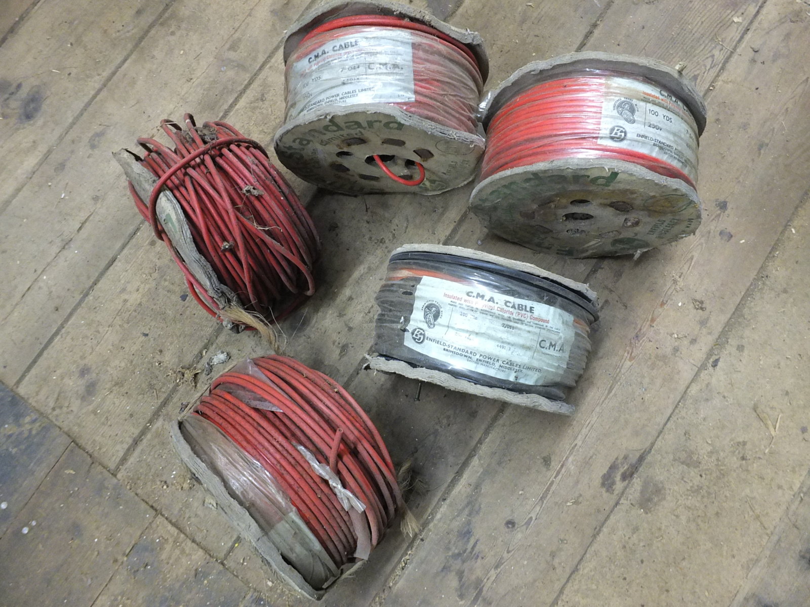

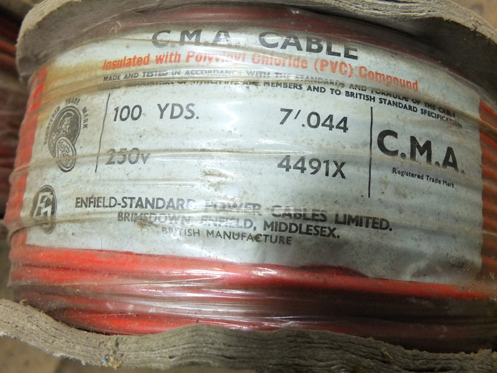

reels of 100 yards 4491X 7/044 red cable

Does this cable conform to current regs or should it be scrapped ? I have 3 full reels and two almost full - 4 x red and 1 black.

It's very old - imperial sizes (7/.044 = 6.9mm²) - I doubt any domestic electrician would want to use it even if it is sound.
Ask an Auto electrician if they are interested.
Ebay or scrap.

Thank you again - may try Ebay and emphasise that it is not to current regs.
It is perfectly to current regs. There is nothing forbidding its use as long as its function is identified by something other than the insulation colour, or it's used for ELV.

It's unsuitable for use in vehicles - not fine-stranded and therefore too liable to damage by vibration.
