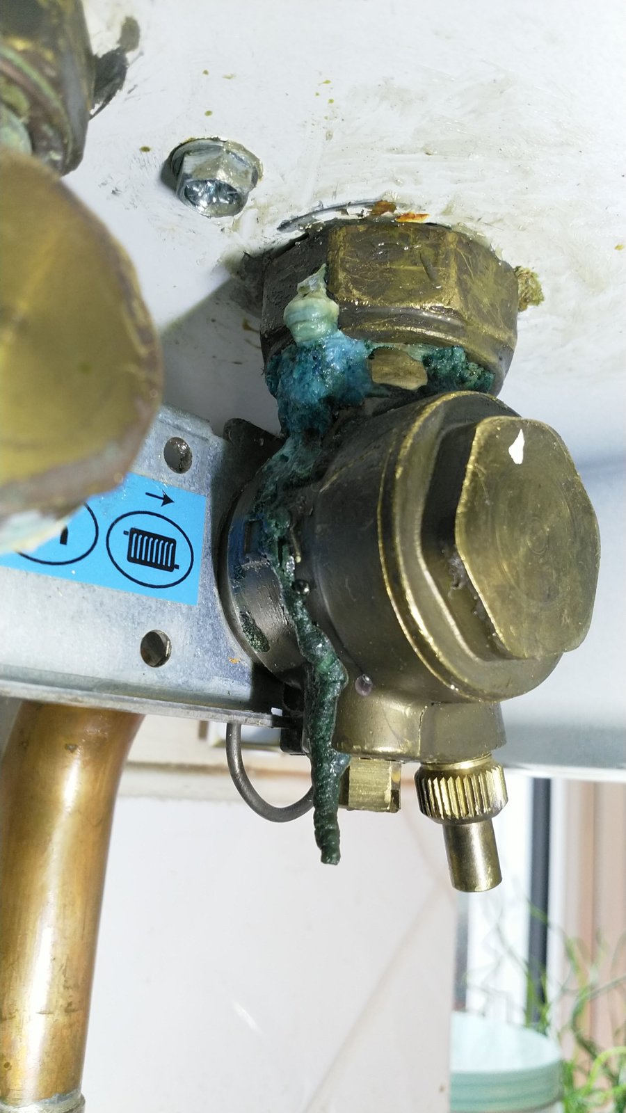

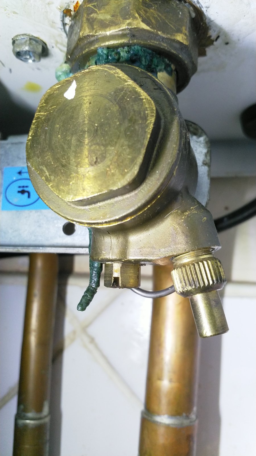

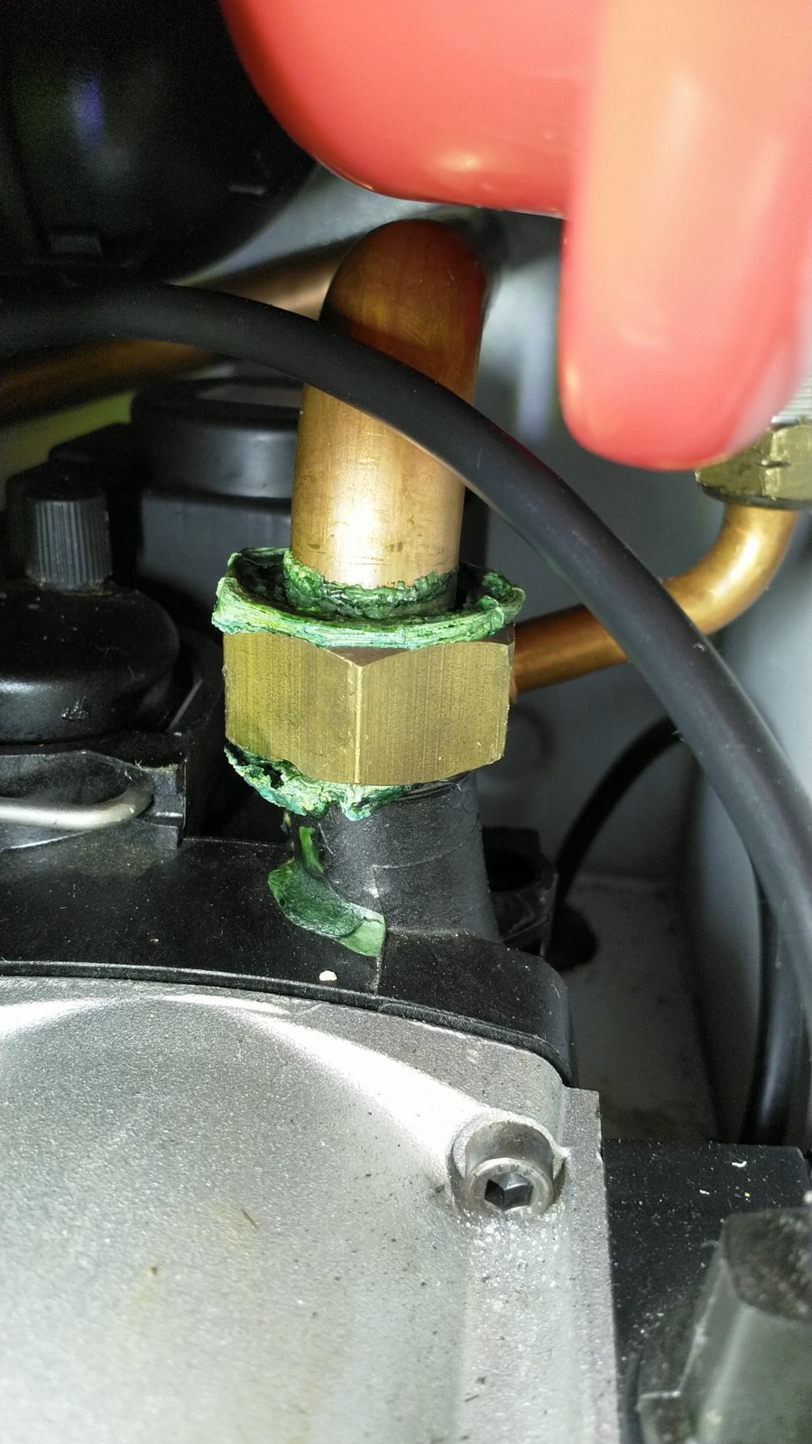

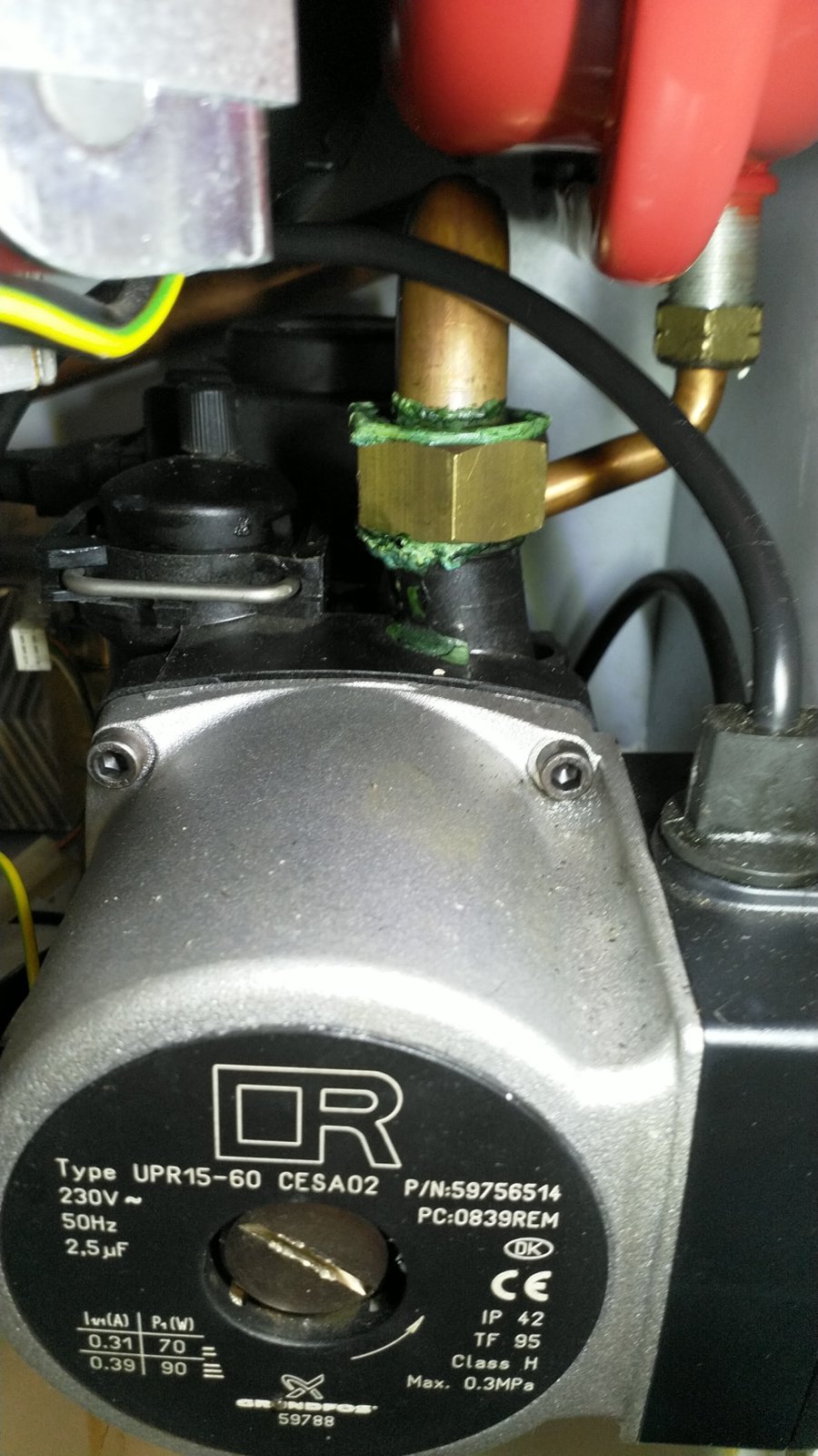

Ok, now I have noticed for a while that the pressure is dropping yet again and upon checking for more leaks, I have found what you can see in the pictures. I think it's the pump itself now?
Boiler still working though, so far.

very unlikely to need a pump, just looks like a washer has perished , shouldnt be too expensive to repair
Agree with the above, it looks like you just need a couple of new washers. BTW you shouldn't be removing the casing unless you're Gas Safe Registered...

Thanks for your answers, will see what the engineer says tomorrow, hopefully it's just that, one or two washers.

Your Remeha is suffering due to the chemicals in the water...perhaps it was overdosed on cleaner or not flushed through. That has softened the seals as evident by the gunk.
A design fault on the Remehas results in condensate wicking up and corroding the exit hole through the casing...some boilers are fine and some are completely rotten. AFAIR the condensate pipework arrangement governs just how much of an issue it can become.

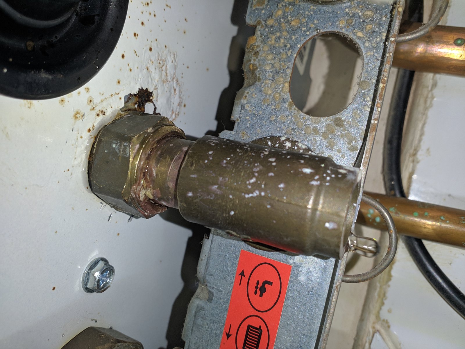

Ok, previous problem posted at the beginning of this thread was resolved by changing the washers.
Now this has developed a second leak on the hot water outlet, just dripping from the nut.
I had a gas engineer come over but they couldn't undo the nut to replace the washer and left. They suggested I should just replace the boiler, which I know, as the state of the boiler is bad with traces of corrosion, but as I said above... Still working on that one.
Any other suggestions I might try?
I'll have someone over for a second opinion, but would WD40 help a bit with undoing the nut or maybe there's other tricks? Thing is now it's actually dripping as he tried to unscrew it.
cant see why he couldnt undo it, you need an engineer that actually wants to do the job and not just flog you a boiler
