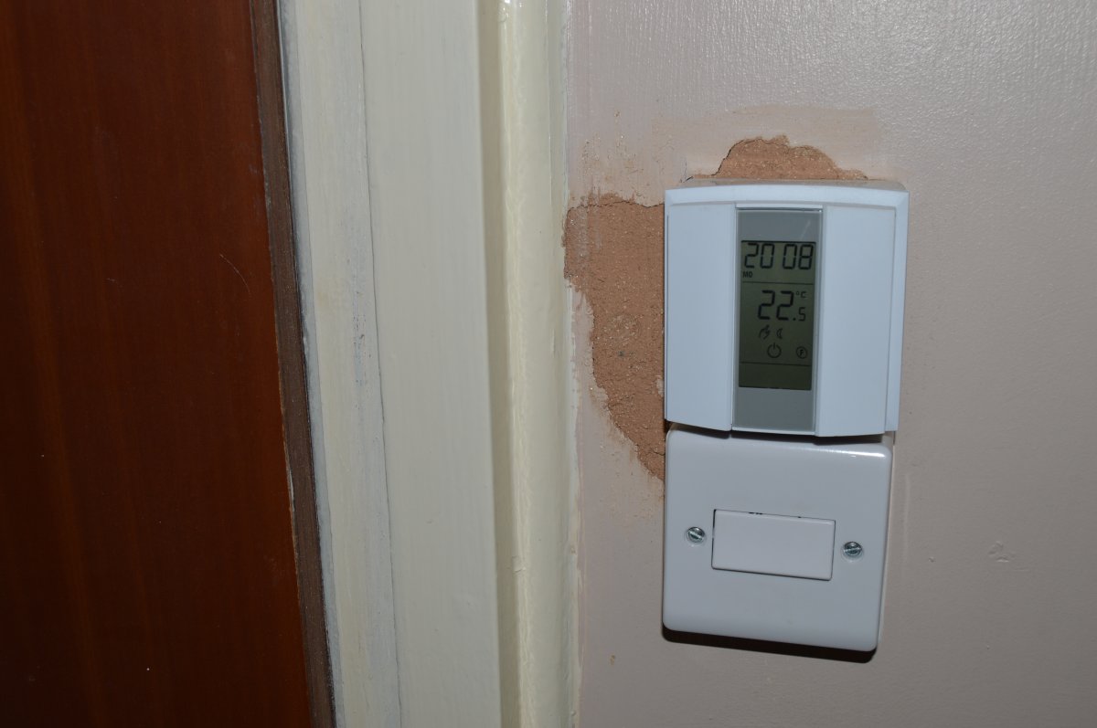

There are no visible cables on either side. The switches are not on the wall between the bathroom and the landing, but the adjoining wall between the landing and a bedroom, 2" from the corner.
The underfloor heating cable goes into the corner, through the wall and then down to the floor on the bathroom side.
Picture attached.

Glad you sent the picture.
I was under the impression those two accessories were fitted to surface mounted boxes.
They appear to be flush.
They can't be any more flush than that.
Would you mind elaborating a bit more on what the problem is please?
Maybe it's the angle of the photo.
Is there a 5-6 mm white spacer between the wall and the accessories? Maybe that's the problem??

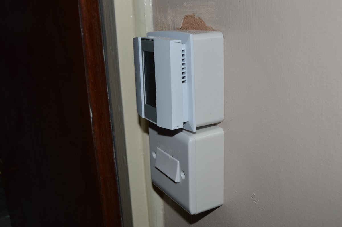

Yes it's the angle, I was trying to show where the cables go. Hope this photo makes is clearer.
The boxes are 35mm deep.
Apart from these, I also have a transformer for the extractor fan (not shown here) which is on a 20mm surface mounted box, and would like to sink that in the wall too.

Ah.
Yes.
I see how ugly that is now.
Best get some flush boxes then. Available 35 mm deep. There are 25 mm flush metal boxes, but don't know how much wiring you have to accomodate.
If it is a solid brick wall (you have indicated you think it is) you need the metal flush knock out boxes. AND some 20 mm grommets.
If it's plasterboard get 35 mm deep plastic dry-line boxes.
If it's an old house and it's lath and plaster then you need metal boxes notched into one of the vertical wooden studs.
