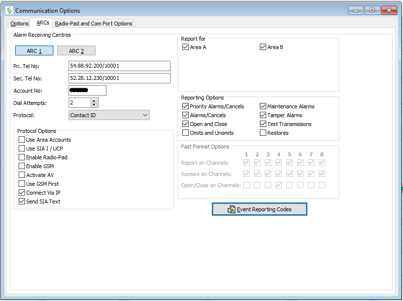

Bit of an issue with push notifications, when PA was activated I got a notification (this was before bell was connected), connected up bell etc all working however when alarm activates bell works but I don't get any notification than alarm has triggered...:confused:

not sure I follow, when you do or do not get the notifications, have you got reporting for alarms as well as priority alarms?
Hi, yes I have the option ticked in Wintex (did program with keypad though initially using the manual).

Yep, I have

Update - I part armed the system remotely which worked, got a notification and email as well that alarm has been set, triggered alarm and then deactivated from physical keypad, no notification or email o_O
Hi Guys
Just an update following an email conversation with Texecom
The reason there was no Alarm notifications when the alarm was triggered is because option 34 (Enable EN50131-1 Requirements) was not set in Global options
