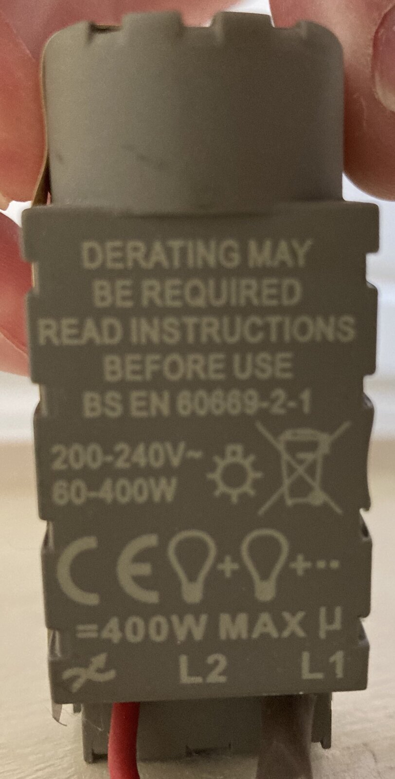

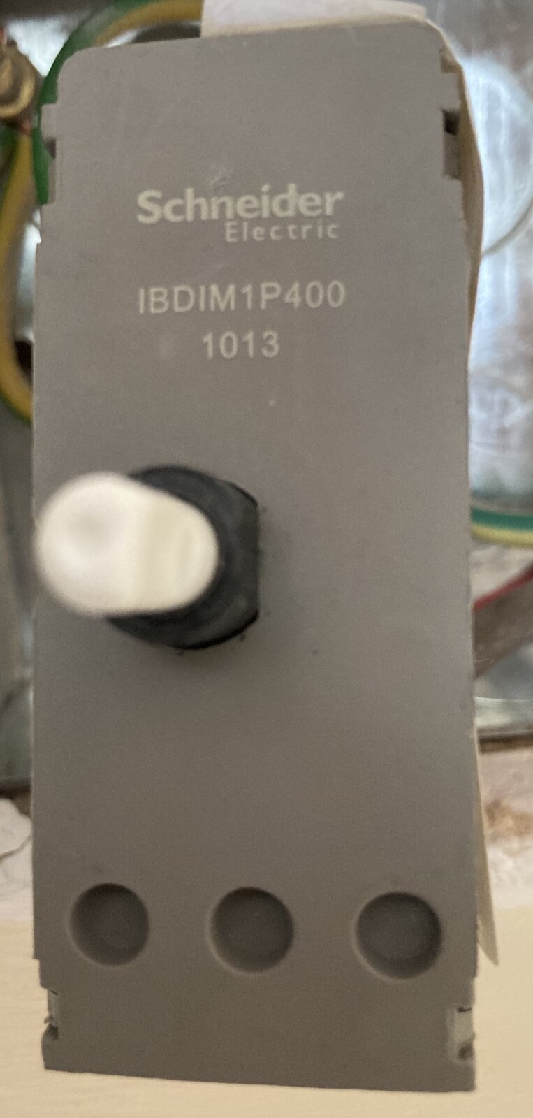

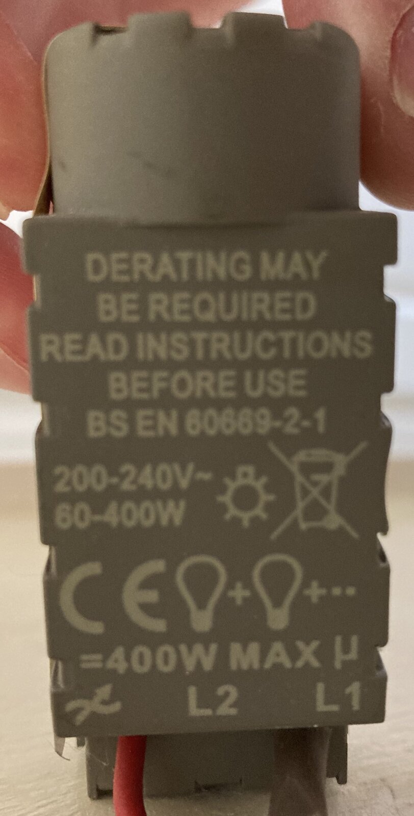

Hi all.
This dimmer switch module has stopped working.
Would anybody be kind enough to recommend a replacement and where I can purchase it. Rather than me buying a whole new light switch and having to chuck the old one into a hole in the ground.
Many thanks in advance.
Are you sure you want the same, replacing that you are limiting yourself to 60 watt load minimum, with the phasing out of Halogen and Tungsten lamps, you will be hard pressed to achieve that minimum.
Fitting a Led dimmer with a low minimum rating may be prudent.
What wattage lamps and quantity are currently in use, if you feel strongly about landfill then your likely concerned about power use, so are you using Led lamps, as that may well have caused the issue you have with the pictured dimmer
You would need a lower wattage today, so easier to swap whole unit. Near impossible to dim CFL and one should not dim quartz lamps as it reduces their life and standard tungsten pearl lamps are no longer on the market, so in real terms dimming means LED.
Many thanks for the advice guys.
Turns out this module was controlling a bunch of halogen lamps. So these are going to be replaced with LEDs.
I'll probably also get the V-PRO Silent LED Dimmer as recommended by flameport.
