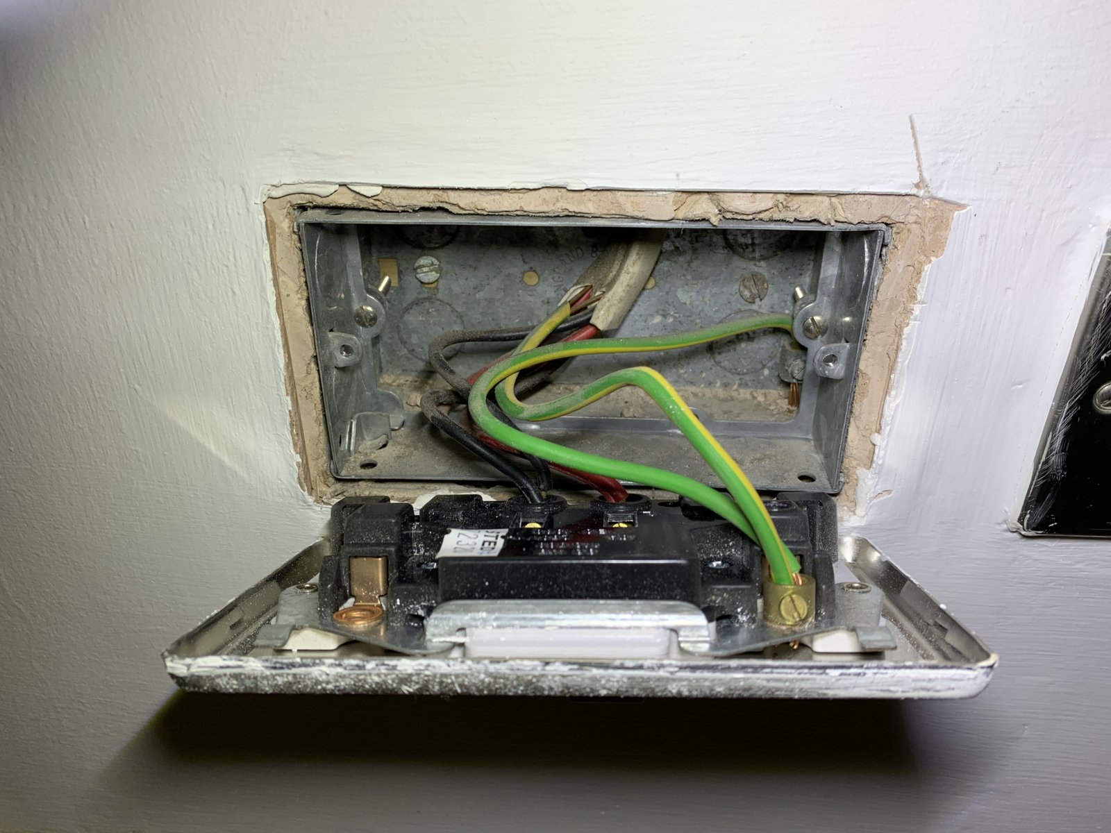

I need to replace this double socket, but the replacement is slightly different to the old one and not sure if I need to add a new earth cable going to the box please?
Here is a picture of the existing socket that needs replacing:

Just replicate what you already have. I.E. three earth conductors into one of the new sockets earth terminals.
The instructions say you do. The regs say if one of the back box lugs is fixed you don’t need to.
Your choice.
Yet another example of manufacturers instructions being wrong or perhaps incomplete.

Thank you and sorry, I'm a bit confused when you say all three earth conductors as I only have two (first picture)? There's the earth coming out the main cable and then the other one that goes to the box. Should there be a third earth cable?

The earth in the cable is actually two twisted together, looks like one in the same sleeve
You have 3 . One in each twin and earth cable ( put together in one green/ yellow) sheath. And a flying earth link to the galvanised box.
That makes the three. Two in the cables in the wall, the third is the one to the metal back box.
