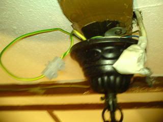

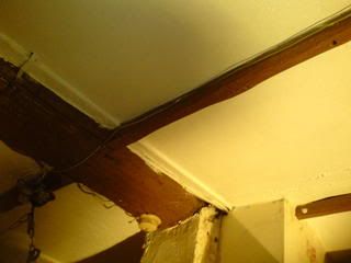

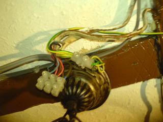

The lighting circuit is not all earthed (& has metal lights fitted), there is a JB or 2 hidden above the celining with no assess to them (as the kitchen is a single storey extentison). :eek:
The old lights
The unearthed Light:
http://i167.photobucket.com/albums/u125/mdbalson/Replacing Kitchen/DSC00109.jpg
The wiring in the other light:
http://i167.photobucket.com/albums/u125/mdbalson/Replacing Kitchen/DSC00112.jpg
The temp earth wire to the unearthed light:
http://i167.photobucket.com/albums/u125/mdbalson/Replacing Kitchen/DSC00114.jpg
http://i167.photobucket.com/albums/u125/mdbalson/Replacing Kitchen/DSC00113.jpg
The light now earthed:
http://i167.photobucket.com/albums/u125/mdbalson/Replacing Kitchen/DSC00111.jpg
The socket circuit has extra bits of cable crimped to the cables behied the sockets, as the wires had been cut too short, & the back boxes are rusty from years of damp in the walls.
The Cooker circuit needs replacing, as the isolator is moving to above the worktop (it is under the worktop at the moment, in the space meant for a small fridge), also an all electric range cooker is going into the new kitchen, which will need a bigger circuit & MCB.
Also all the lighting & power wires are on show at the moment (clipped up around the celining)
