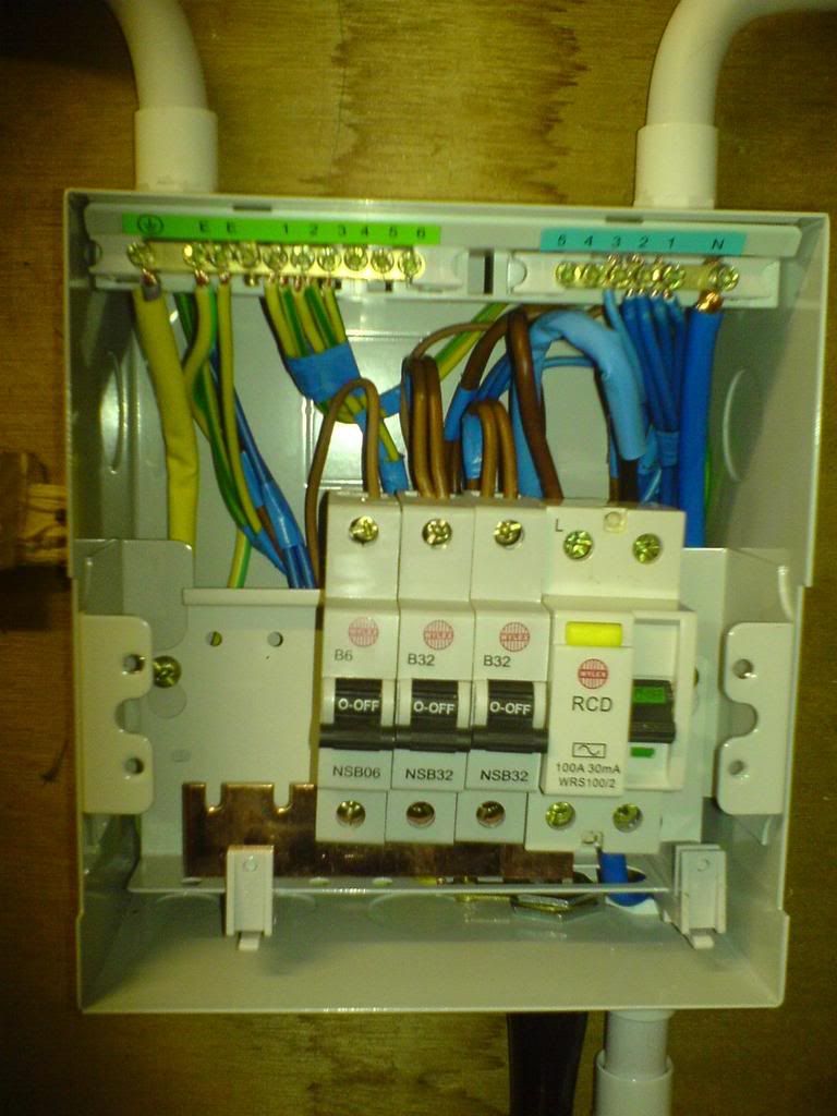

New Shed CCU is a Metal Wylex 5 way Consumer Unit with a 100amp 30mA RCD mains switch.
Put in three Metalclad DP double sockets along the worktop, & a Metalclad switched FCU for the 2kW Heater, which will be on a Ring Main, on a 32amp MCB in the shed ccu (Plug the Tumble Dryer into one of these sockets),
Have the pond pump, an outside socket, the LV Garden lights (x2), the light in the summer house, and the pond lights as a Ring circuit on 32 amp MCB in the shed ccu.
Put the shed light, & the outside shed light (the light above the shed door) on a 6 amp MCB in the shed ccu.

New Shed CCU:
http://i167.photobucket.com/albums/u125/mdbalson/DSC00050.jpg

Close up of shed CCU, showing earthing tag on the SWA:
http://i167.photobucket.com/albums/u125/mdbalson/DSC00075.jpg
Shed CCU with innerds in:
http://i167.photobucket.com/albums/u125/mdbalson/DSC00074.jpg

The CCU Wiring
The CCU with all the Earths & Neturals connected:
http://i167.photobucket.com/albums/u125/mdbalson/DSC00144.jpg
The CCU with all the wires connected:
http://i167.photobucket.com/albums/u125/mdbalson/DSC00146.jpg
The CCU with live busbar cover on:
http://i167.photobucket.com/albums/u125/mdbalson/DSC00149.jpg
The CCU with the cover on it:
http://i167.photobucket.com/albums/u125/mdbalson/DSC00148.jpg
Close up of the MCBs in the CCU:
http://i167.photobucket.com/albums/u125/mdbalson/DSC00147.jpg
Please do not ever buy a block of flats. :p

Did you miss with some of the SWA strands? They should all be in the clamp, some of them look like they have gone up the inside of the gland. Is it the correct size gland for the cable
All of the SWA strands are gripped in the gland, & it is the correct size of gland for the cable ( 20 Gland which is for 3x6mm SWA)
I have to say, it does look neat.
I hate inspection tees/elbows though - you loose marks for those. Should have used circular boxes ;) I prefer to see pulled bends where possible.
The insulated enclosured on the house wall look poor IMO - Just not very neat and tidy.
The T+E also enters the rear of the enclosure, and is sealed with mastic - not ideal.
Cleats too large on the 'freezer swa'??
Conduit entry into the top of an IP rated enclosure? I hope you drilled a drain hole? I would always try to avoid entering the top with conduit/swa/trs etc.
Is the chase in a 'safe' zone?
Cable ties would be better inside the grid switch if you REALLY feel you need to group cables.
Tape on the earths and neutrals in CU is cack. It is not needed.
Is the banjo on the CU swa nut and bolted through the case? lookes like you have bolted the cable to the banjo, and then put it into the CU?? How can you tighten if it ever becomes slack? How can anyone check it is tight?
Pulled bend out of top of CU looks good - well formed. Bet that took practice and few lost lengths ;)
Male conduit adaptor in bottom of grid sw back box - A female would have better suited.
Do you have a new digi-camera-toy or something :LOL:
There is also the rubber seal of the box, around the T+E.
Yes. :oops:
I think it is as you can see the cable coming out of the chase in the meter cupboard, & also the cables will be covered with steel capping, before the chase is plastered over.
Yes I know it would be, but B&Q ownly do 25mm conduit adaptors in male.
