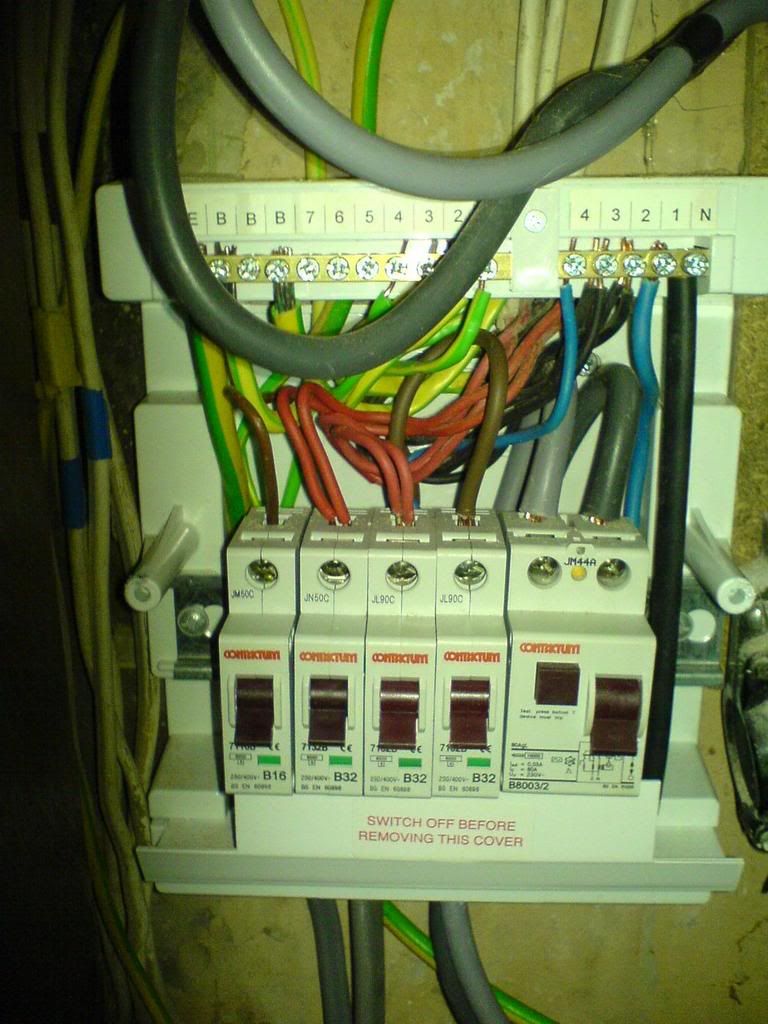

Yes I am going to do a board change, as there are no more spare ways left on the 2 old CCUs, & so that there will be only 1 big CCU for the whole house (with all the socket circuits on RCBOs)
I will be replacing the 2 old CCUs will one new MK 21 Mod (19 Ways) CCU with RCBOs for the all the socket circuits, & a lock on the lid to stop my 3 year old brother from turning the breakers on & off.

The wiring in the old MEM CCU:
http://i167.photobucket.com/albums/u125/mdbalson/DSC00291.jpg
The wiring in the old RCD CCU:
http://i167.photobucket.com/albums/u125/mdbalson/DSC00013-1.jpg

These are both substantial jobs for someone part qualified to take on.
What are you going to do regarding testing? Do you have the relevant kit, know how to do the tests and do you know what the results indicate (especially bad results)? The LABC will expect test results.
A board change involves major responsibility; you are basically going to affect every circuit in your house. Do you know if the circuits are suitable for breakers and how you confirm this?
When you disconnect the old boards, you cannot go back. Leaving a house with no electricity, when a 3 year old lives there is not funny.
If you start the job and can't finish it, you are going to struggle finding a spark to sort it (and the cost will be scary).
I can't stress enough that you should step back and leave this to a pro.
You could even ask if you could work with him and pick up some tips from him.
The old circuits are on breakers at the moment, & I will be testing the 4 old circuits.
There are 4 old circuits: Upstairs lights (6A), Downstairs Lights (6A), Upstairs Sockets (32A RCBO), & Downstairs Sockets (32A RCBO), which are on Type B MCBs at the moment.
There are 11 new circuits: Alarm (3A), Smoke & CO2 Alarms (6A), Immersion Heater/ CH (16A), Shed Freezer (16A RCBO), Kitchen Fridge (16A), Loft Sockets (20A RCBO), Shed Power (32A), Cooker, Kitchen,Utility, Bathroom & Back Outside lights (6A RCBO), Kitchen Sockets (32A RCBO), & Utility Room Sockets (32A RCBO)
mdbalson said:
The old circuits are suitable for breakers, as they are on breakers at the moment.
That single sentence should tell you why you don't know enough to do these jobs. When you change a board you take responsibility for the full installation. You can only sign the job off after you have inspected and tested all existing circuits. The fact your lights work and you can work at your PC doesn't mean the circuits are installed correctly and are safe.
IMO that somebody with 2330 L2 is nowhere near ready for unsupervised jobs like the ones you seem happy to jump into. As the saying goes "A little knowledge is a dangerous thing" Get a spark to do these jobs.

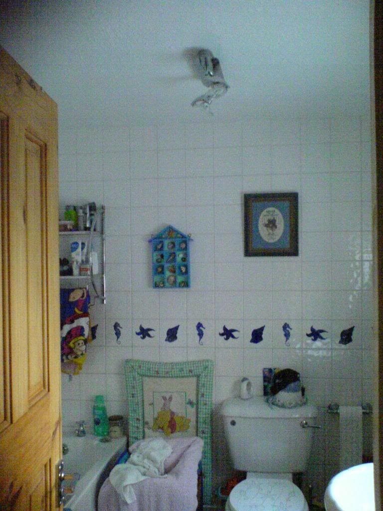

Here is a picture showing the relationship of the bathroom light to the bath, etc.
http://i167.photobucket.com/albums/u125/mdbalson/CopyofDSC00063.jpg
Close up of Bathroom Light:
http://i167.photobucket.com/albums/u125/mdbalson/DSC00064.jpg
securespark said:
To be fair to mdb, CCU is in the regs definitions as Consumer Control Unit.
I hope the bathroom light fitting(s) are suited to their zone.
You don't have to use 5A sockets, 2A would be fine, assuming the load does not exceed this value.
Bottom of fitting > 2.25m of floor? If so, it is in Z3 & OK

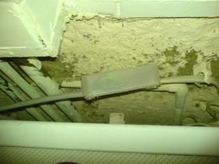

How NOT to Join a Cable
Close up of the Bad Joint
The joint in the 2 pictures above was buryed in the plaster, the cable with the joint in, goes to the bathroom light
The old hole from the Bathroom light switch

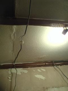

How can I replace the joint in the pictures below :?:
As this cable (on the left) goes to the bathroom light, & cannot be replaced, as the cable runs under some of the tiles in the bathroom.
Could I crimp the old piece of cable to a new piece of cable, & wrap tape around the joint, & then put the joint above the ceiling :?:
If you don't know whether crimping is okay, don't you think you should at least think of getting somebody qualified in to do the job.
Is the bathroom upstairs? If so put the light on that circuit and blank off the existing switch. Crimping would be okay, but it's a bodge during a rewire.
The bathroom is downstairs, off of the kitchen. I would have liked to replace the piece of cable, but to do so would mean chiping off some of the wall tiles in the bathroom, to replace the cable. (the bathroom is a single storey extension on the back off the house)
So crimping a new piece of cable, to the old piece of cable, would be ok :?:
