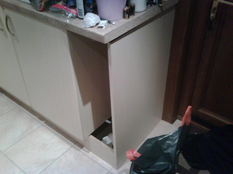

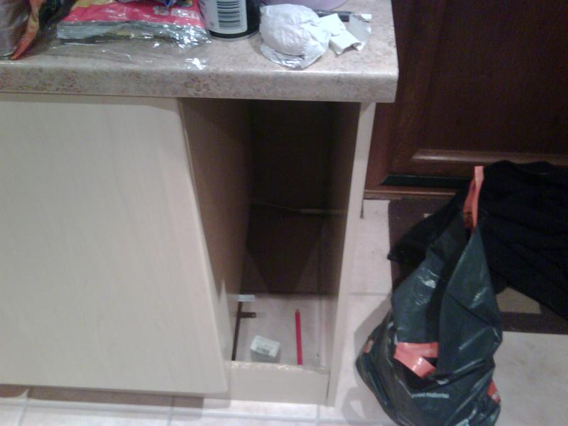

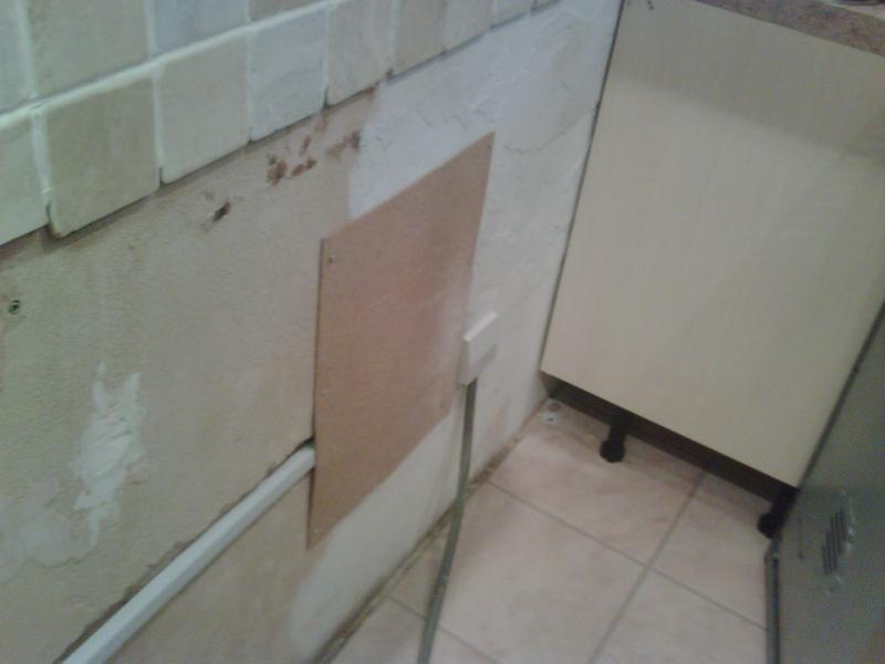

Why didn't you . . . just take out part of the back panels of those cabinets? IMO enough support would be given by just having a partial panel, and the cabinet butting up to other units and fastened to the worktop.
All those holesaw'd holes . . . just looks messy.
Is that flexi pipe from the sink waste? Not seen that before.
Yes I think so but not too late, can cut another smaller back panel in with maybe a shelf holding it in.

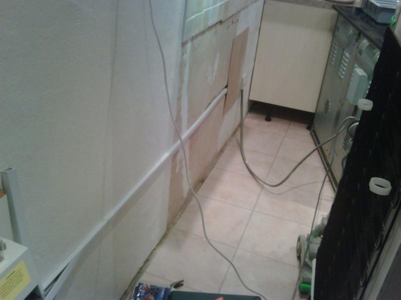

Here is another update:

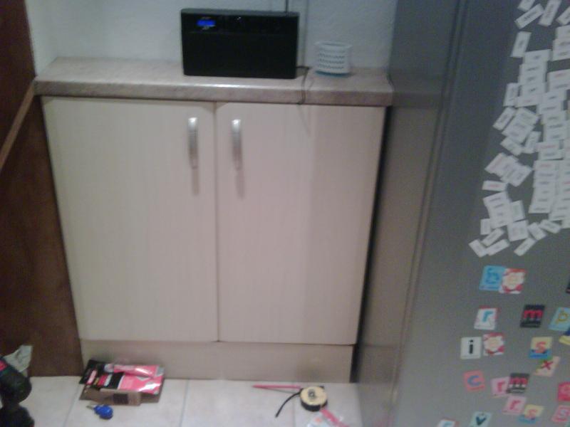

Door side of Kitchen
Back of Kitchen

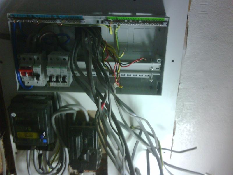

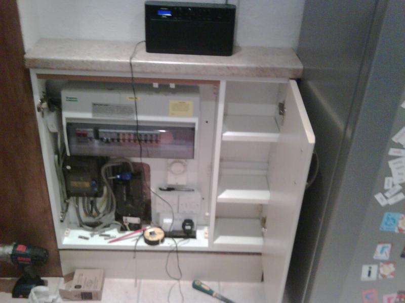

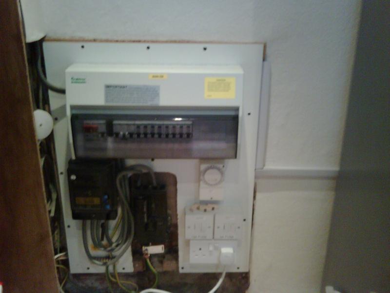

Temp Electric Supply
Temp MET
Temp jb for Downstairs/Kitchen Ring
Temp lighting circuits supply

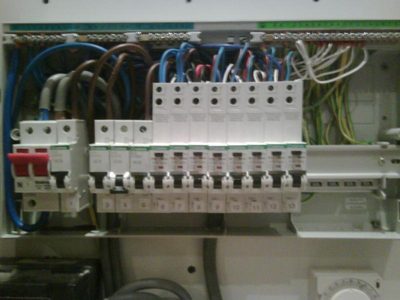

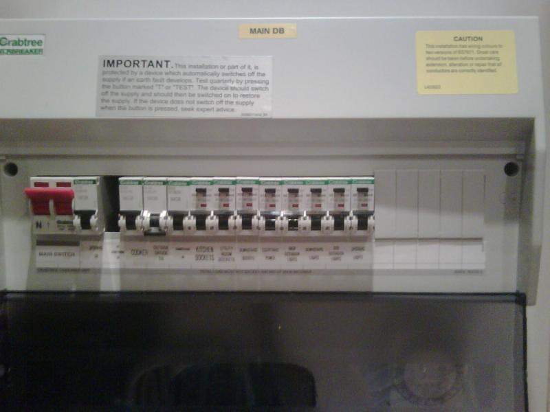

Temp CU's
Top non-RCD CU is for:Shed Submain (40A), & temp Courtyard Socket (16A)
Bottom RCD CU is for: Cooker (32A), Downstairs/Kitchen Ring (32A), Upstairs Ring (32A), & Shed Freezer (16A)
Even though its temporary, you could have made that look a LOT better.
No disrespect to the op but i'm a professional spark and have to say from looking at the pictures the installation is shocking! Very poor installation work and alot of things that make me cringe when i look at the pics! If an niceic assessor (or other scheme assessor) was shown around this job and he could see all the pics it would instantly fail!
