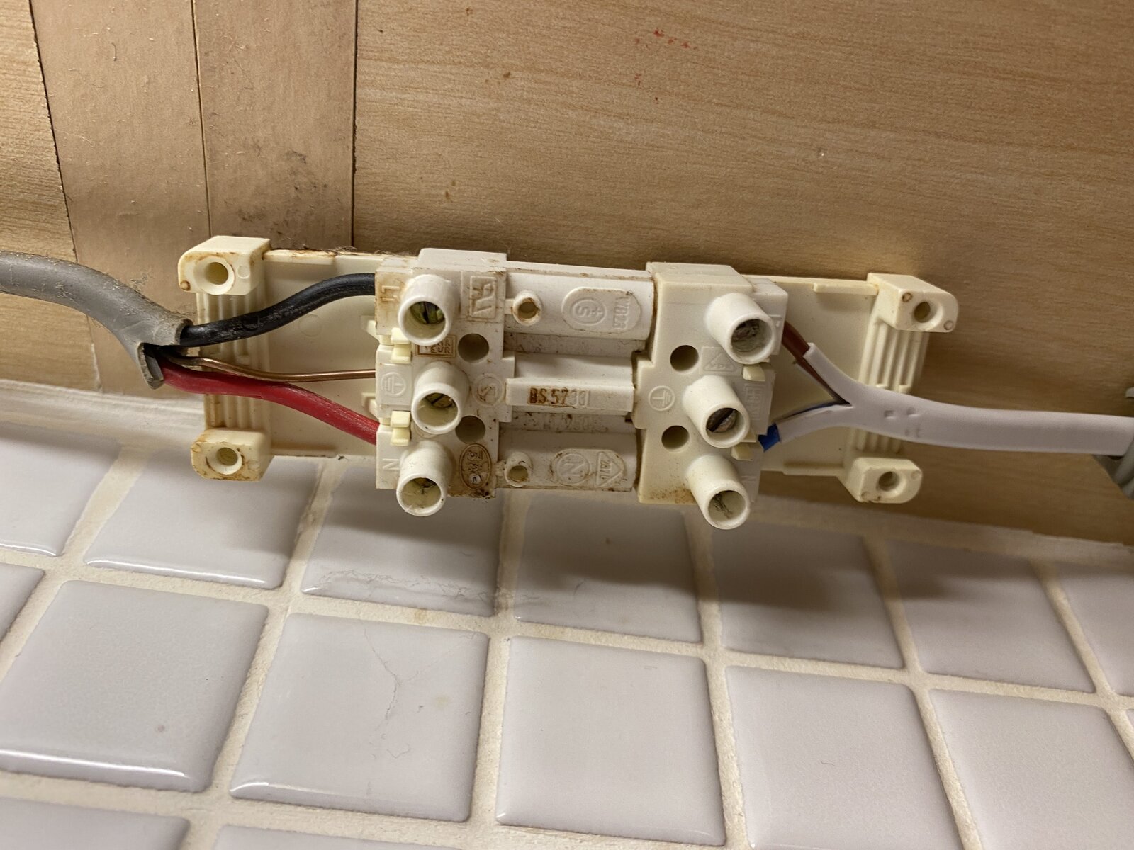

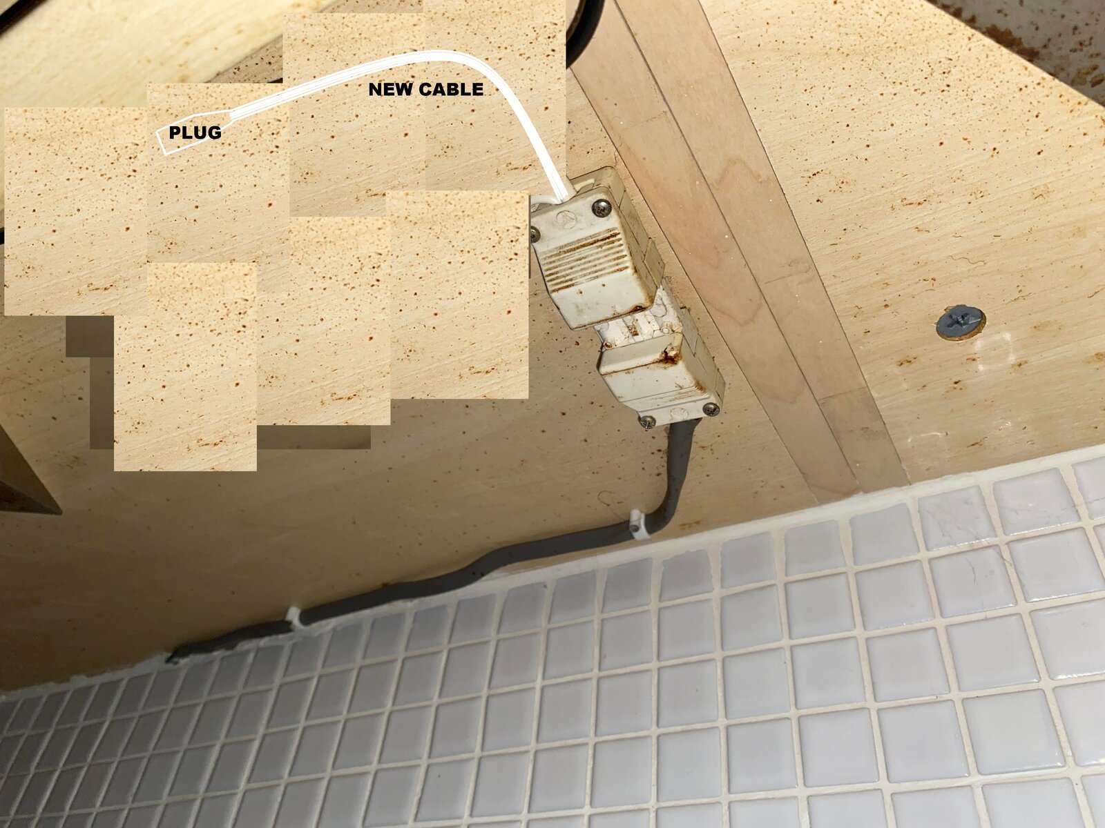

Pictures of existing connections below (1 wall has single T&E cable, 2 walls have 2 T&E cables coming out)

I can't see the images you posted so don't know the current arrangements, quite often the under cupboard lights use wall warts [transformers built into 13A plugs] and I wondered if thats what you currently have.
All you'll require is a junction box of some sort to join the new flex to the existing T&E cables.
Apologies, the images should now display properly. If not please let me know and I'll re-attach them here.
Oh good, in that case keep those connectors in place and connect your cable into the existing plugs

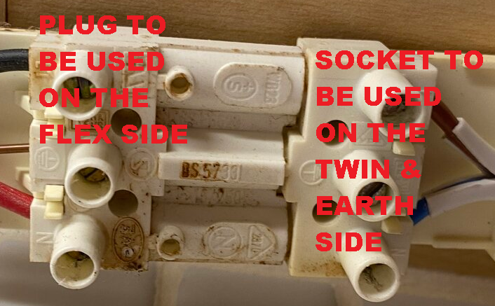

Just to check we're both on the same page, you mean wire the cable from the cut plug into the other half of the connector (shown in the last photo)?

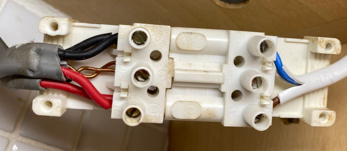

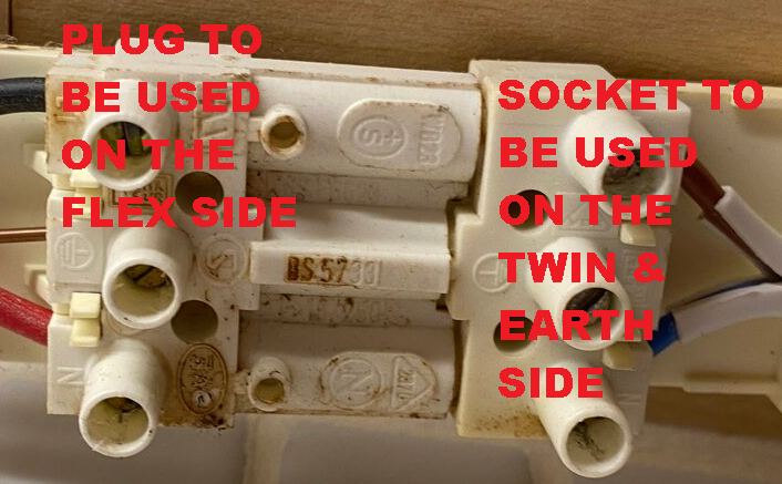

Two of the three light connectors (that I removed the old light fittings from) had their neutral and live wires in the wrong way round. One of the three mains connectors had the cables the wrong way round too.
Like this:
Connector 1 - [Mains correct] [Light correct]
Connector 2 - [Mains correct] [Light incorrect: brown to N and blue to L1]
Connector 3 - [Mains incorrect: black to L1 and red to N] [Light incorrect: brown to N and blue to L1]
I made the decision when connecting the new cables in to connect using the correct terminal colour matchings (brown to L1, blue to N).
My assumption was given the connector into the LED light strip is not polarised (I don't think, see final image below), it didn't matter either way. I decided to correct them, as it felt wrong wiring to wrong terminals. The connector 3 disturbs me the most, as the mains end of the connector still has the wires the wrong way round.
Is it common for lighting wires to be placed in any terminal? Is what I did ok? Was it sensible? Or should I have taken it that the last person to work on the electrics new something I didn't and wired it like for like (even though the colours didn't match the terminals)?
It now looks like:
Connector 2 - [Mains correct] [Light wires were brown to N and blue to L1, now brown to L1 and blue to N]
Connector 3 - [Mains incorrect - I've left alone] [Light wires were brown to N and blue to L1, now brown to L1 and blue to N]

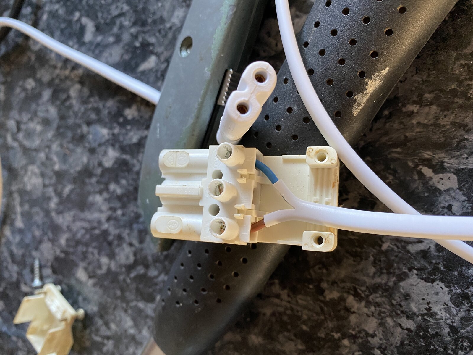

LED light strip connector
It took me a few moments to realise what had happened here. the connectors have been used the wrong way round. I'd suggest turning them round as the live pins will be exposed if unplugged.
Other than that looking OK.
Ah, that makes a lot more sense. Thanks for your advice so far - it's really appreciated.
One of the terminal screws was pretty chewed up, so if I'm disconnecting I should probably take the opportunity to replace with new connectors. What is their proper name (a quick search for "connectors" on Screwfix throws up a lot of results!)?

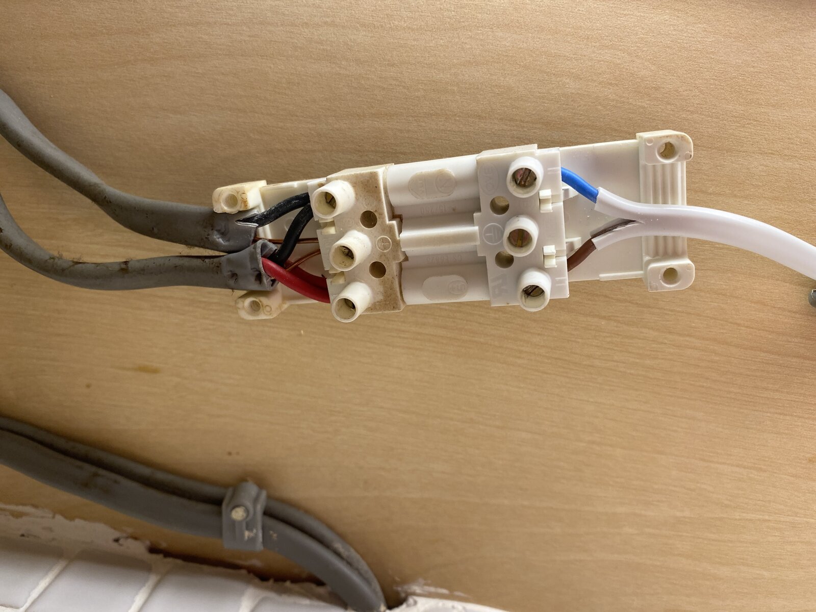

Also, the included live-mains cables were quite long. I probably should have trimmed at least one of them down (but didn't). I did try to make sure it was spread out. The photo below is the worst of the three. Is it ok to leave this excess cable (if I use some more cable clips to tidy/make more secure)?
