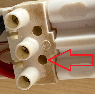

The lights have been in and working for a few days now, but from the above and reading back through the comments, there still seems to be a potentially hazardous issue if connector 3 is separated while the circuit is live (in reality I'd always disable the circuit before disconnecting anyway, but guess others may not).

Connector 3: Connectors are the wrong way round, mains cables the wrong way round (black connected to L1, red connected to N). Also the lighting side was previously wired incorrectly too, but since my recent work, that side is now correctly wired to the indicators on the terminal (but now doesn't match the mains side).
So to finish this job, I need to re-wire Connector 3 the other way round (and at the same time might as well replace it and secure the correct wires to the correct terminals!). Correct?
With regards to screwing the (mains) ends of the connectors to cabinets, there doesn't seem to be a hole in the connector to do this (or do I need to drill through the two recessed holes in front of the terminal connectors, and attach that way? I don't want end up with a screw made live, and going into the cupboard!
I was thinking these holes could be used but in hindsight I have a feeling there are corresponding pins on the covers to fill them.

I've replaced the lighting connector with a new one, and wired it the correct way round.
I cut and re-stripped the T&E wires so as not to screw on wire already flattened from previous screws (not sure if necessary).
The instructions for the connector stated the earth needed to be at least 8mm longer than the live and neutral (I assume so if the cable gets pulled out, this will be the last to disconnect), which made fitting difficult - in the end I bent the earth wire upwards to allow the live and neutral to reach the terminals).
There were holes for 3 T&E cables, so I covered up the other two with electrical tape. Probably not necessary, but I wanted to minimise dust, moisture and/or debris entering the connector.
Finally, I cut down and re-routed the cable that was too long. Not quite as nicely as SUNRAY's suggestion, but as this cupboard was next to the cooker, I wanted to avoid moving the connector in that direction.
If anyone spots anything awful, please shout out :)
Original connector (T&E in wrong side of the connector, and live and neutral in wrong terminals):
New connector (wired correctly, and to correct part of connector):
New connector, with bent earth:
Trimmed/tidied wire:
