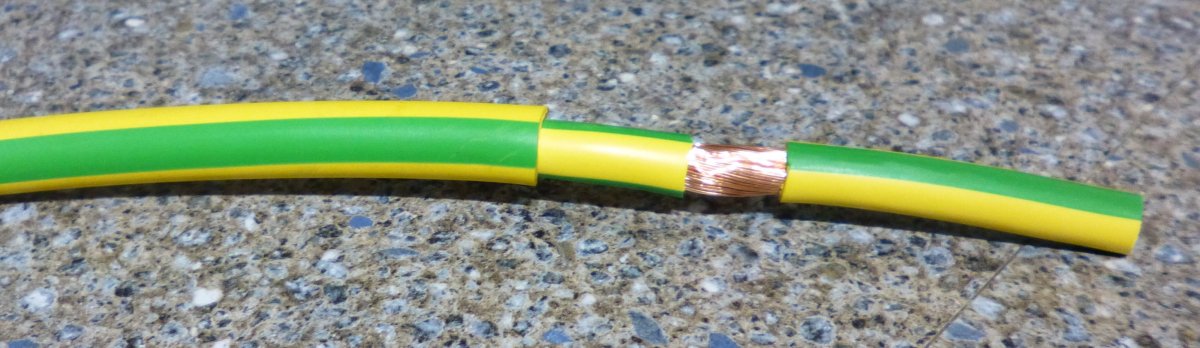

Does tri-rated count as sheathed ? It looks just like a single layer of insulation to me, which surely precludes it being used (eg) between meter and CU and it wouldn't normally be practical to provide the mechanical protection right up to the meter terminals that the over-sheath of the "normal" meter tails provides.
I did say insulated and sheathed tri-rated cable. I've only got green/yellow to hand for the photo, this bit is 25mm².
