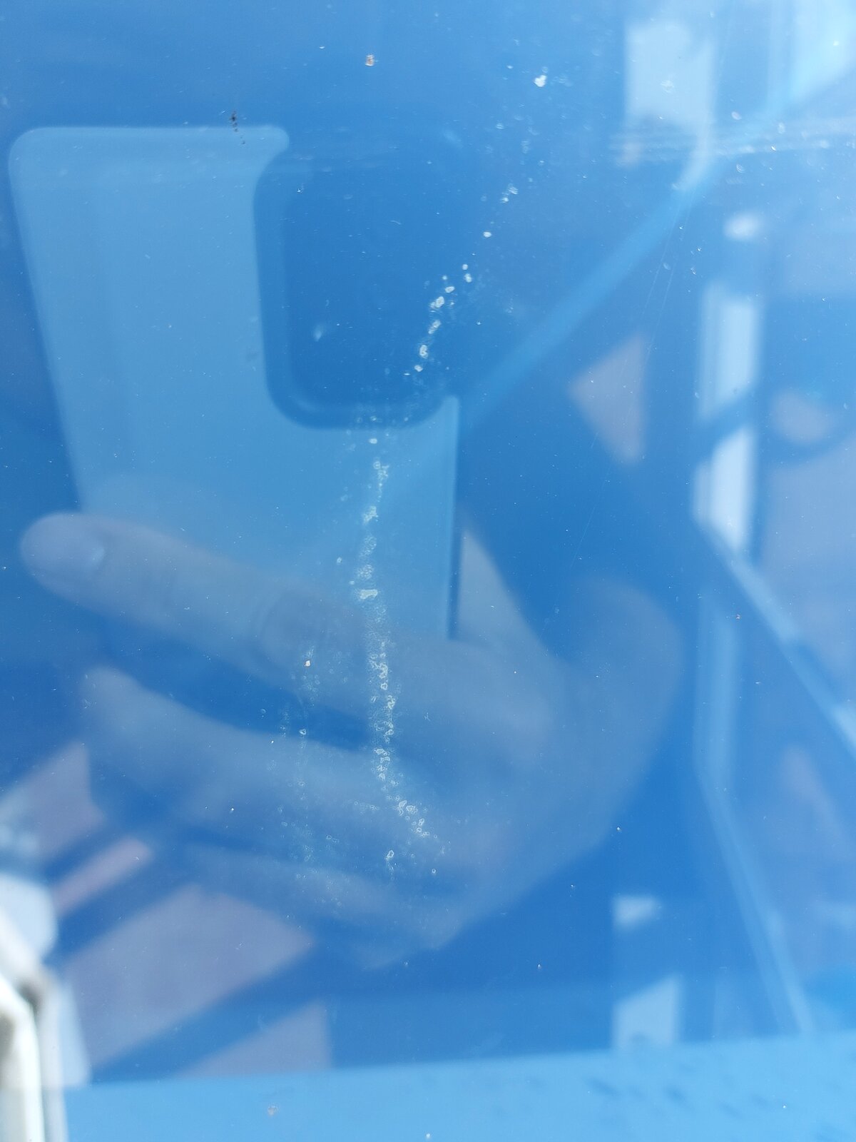

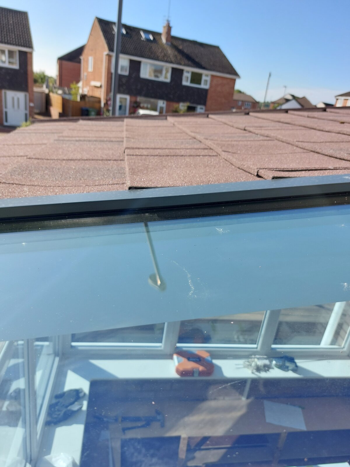

Hi, so I got installed warm roof on the conservatory including fancy glass panel . However the glass panel behaves weirdly, as when there is a sun light, it gets very hot in the inside and is basically emitting heat into the room. Also now there appeared some sort of weird blistering on the inside of the panel . (its I think double glazed, and this is in the internals). I had tried contacting the producer, but they refuse talk to me as I'm end customer, so I was wondering if anyone has some experience with those to at least tell me the warming form the inside is all right, or they actually could have fitted it other way around with the coated/reflective side facing inside, rather then outside. So I have some more leverage towards the installer, as they say all is alright. (well not the blistering, thats a new thing and I'm waiting for their comments on that)

as the producer doesn't want to speak to me, I can't get more info. But yes, it look like some issue with film that is on the inside side of the outer panel. And I hope this is clear reason for replacement as this shouldn't happen after 4 weeks it put on.
I'm mainly interested in the warming part. If it is normal for those coated windows to get super warm even on the internal glass panel? I would assume only the reflective/outer part should get hot, but the interior facing glass should stay cold. Or it is really normal for the coated glass (even velux) to act like a heater?

the panel is currently in the shade, so I need to wait for tomorrow and how for the sun to measure the temp.. However sun is directly shining directly onto standard double glazed windows and they are 33 deg Celsius. And comparing with other objects on the direct sunlight right now I would estimate the temp of the roof panel in 50-60 deg ballpark.

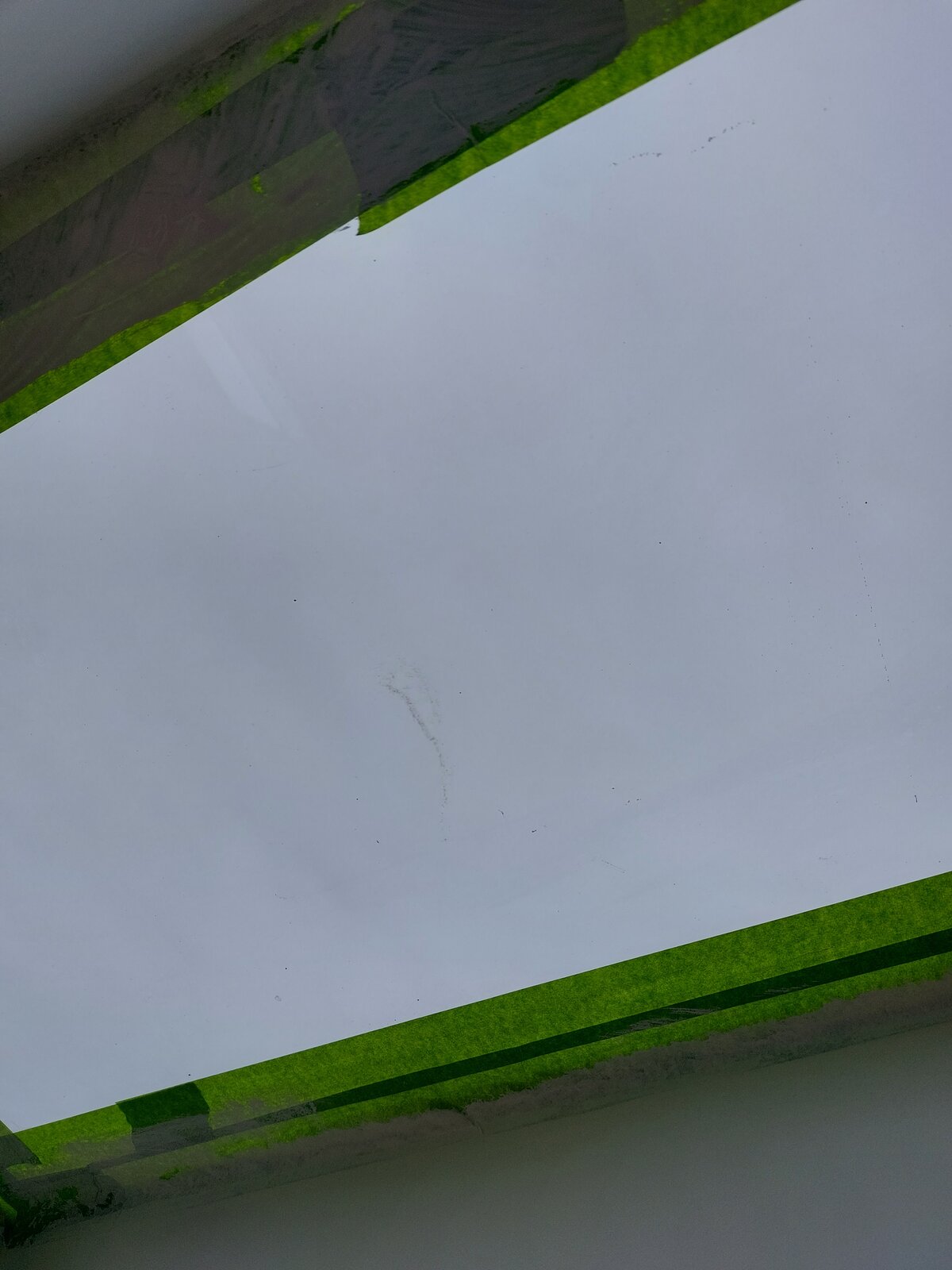

I am a lowly decorator..but the dark mark in your image looks like a scuff mark.
With regards to blistering, that might be water ingress (but you would expect water stains first.. Photos from above and without the tape will help people more knowledgeable than me to respond though
Edit- whoops- I was looking at the mark on the glass

so today is sunshine, and even though sun is still low, I did some measurements
roof slate - 44C
roof glass panel outside - 22C
roof glass panel inside - 49C
ceiling inside - 23.6C
conservatory double glazed window outside - 22C
conservatory double glazed window outside - 29C
so the inside part of the roof glass panel is the hottest thing around.

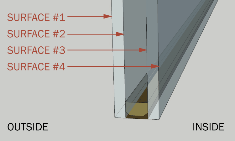

I took some better photos. Just to be clear, it is no the Surface #2 for the schema attached.

And I'm guessing you can reach the glass unit from outside, so just wondered if you could feel the ' blister ' or whether it was on the internal face of the sealed unit

yes, there is a blue tint to the window. And I did lighter flame test today and there is something on surface 2 and even surface 1.
yeah, look at the schema posted above, its is surface number 2. so the internal face of outside facing panel
