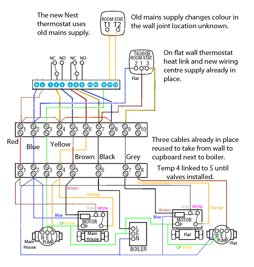

My boiler is a concord WCF 255. I struggled to find anything about it online.
I'm not sure how the runs can be separate when it all fills from the same fill point by the cylinder and drains out through a shared drain valve.
Originally the three port and zone valve were not there. I added those in to give me the ability to force the water either through the whole system or just the cylinder, and the zone valve to heat both floors or just upstairs.

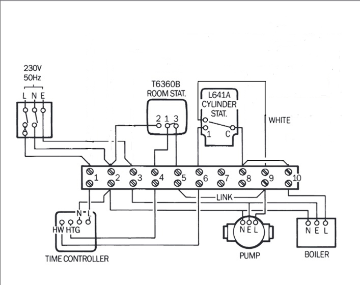

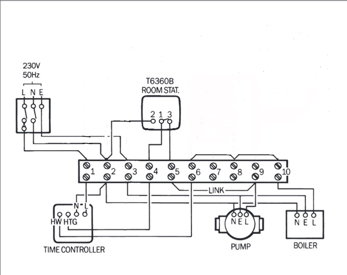

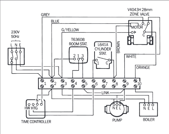

I have found an old post from forum regular @ericmark which very helpfully shows the three incarnations of C-Plan. It looks like you originally had the middle one i.e. there was a cylinder thermostat, but there wasn't a 28mm zone valve on the hot water circuit. If a 28mm valve is added, I believe it has to be the specific version for C-Plan which has an extra wire.

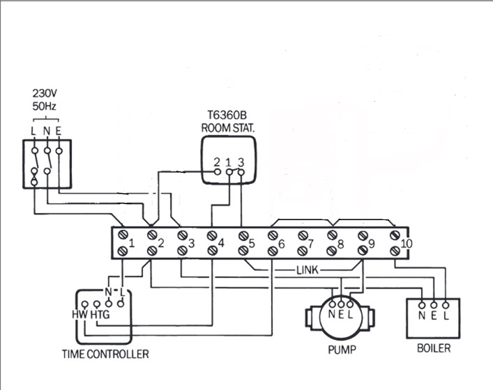

C plan has changed over the years, first View attachment 266854 then View attachment 266853 and thenView attachment 266852 seems you have latter, since you can turn off the thermo syphon you can control DHW temperature summer and winter, and it can work either CH only or DHW only.
However it does depend on the house, I found even with CH pump turned off some radiators would thermo syphon, main problem is when CH is turns off but boiler remains on for DHW then since circulation started for CH it continued.
I have C Plan but basic first one shown, I do have motorised valves but to select with part of house is heated, or more to point not heated. I found although two pumps one for flat and one for main house, turn off one pump and the water flowed in reverse direction.
Plumber did point out if the TRV's close you should not get any flow, but flat TRV's were simple wax type and never seemed to be fully off.
He advised me not good for boiler fitting a motorised valve to DHW as no run on to cool boiler.

My setup doesn't even have a cyclinder thermostat. Like I said, the temperture must cap out to whatever the boiler thermostat limit is because the water is scalding hot.
Looking at those wiring diagrams though, it looks like I can have a direct call to the pump. I'll go ahead with my solution then and see how it goes. Thanks for your help.
This was the start of my central heating wiring, not got the completed version on this PC, it had a fault in that without a relay, now fitted, I could not switch pumps independent of boiler I had expected to plumbers to move to a single pump, but they left it with two pumps.
In the original installation they thought, by selecting the pump, they could select main house or flat, but selecting just one, causes reverse flow in the other. My problem is floor panels which have needed repairs putting plywood on top, which means hard to access any wiring, and the three core and earth changes colour between house and flat, and one core open circuit. Which is why I selected Nest Gen 3, as all will go through 2 wires, however Nest has proved not to be as adverts said, and will not link to Energenie TRV heads, so now has a Wiser Thermostat in parallel so I can monitor both hall and living room temperature, and add bedrooms if required.

I'm planning on how to wire my modernised heating system at the minute, which would include creating a new wiring centre and adding the cylinder thermostat. Right now all the valves are operating passively to whatever I set them to.
