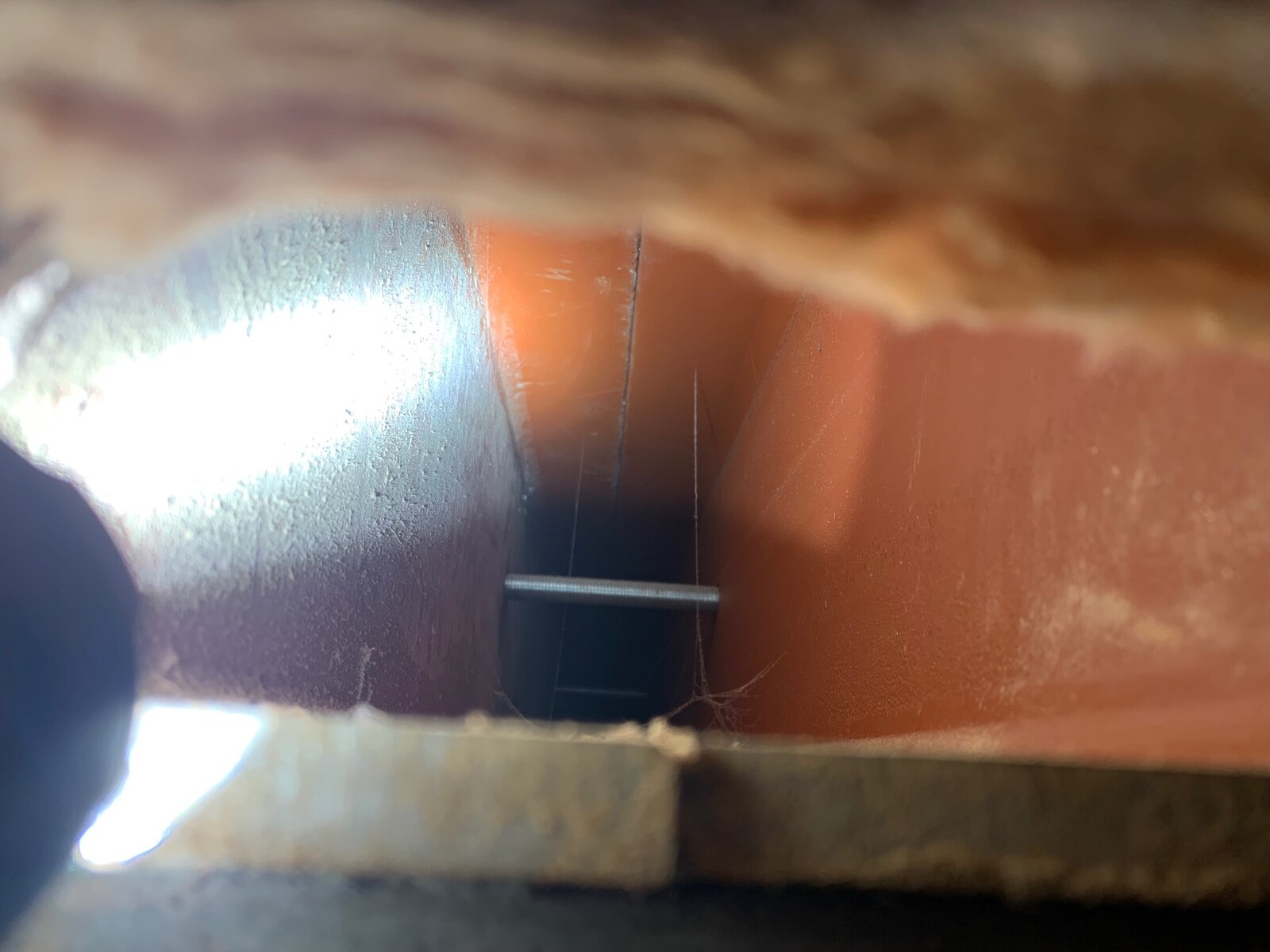

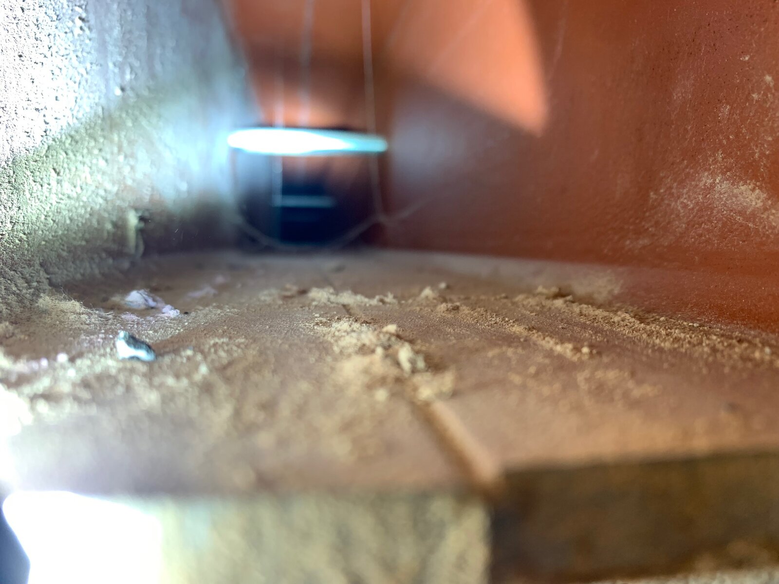

Guys,
Any advice..
SE specified bolts and spacers necessary. Builder has added bolts but not spacers. The work is up and he is saying spacers are not needed and is pushing back (basically refusing) on making changes now.
The beams sit right next to each other - no space in between - is it even necessary to have the spacers?
Hopefully someone can let me know what the purpose of the spacer is? is it purely to ensure the beams do not move apart?
I spoke to SE and he has advised if spacers not used and beams are not coming down I can weld a steal plate to the underside to tie the beams together.
Thanks in advance
John
If the beam flanges are butted then no spacers are necessary. The bolts and bar keep the beams together, spacers stop the beams being closed in as they tighten. If they are butted (which they often are with large section beam and small cavity), no need for spacers.
Tube spacers perform the function of load-sharing by binding the beams together so that they act as one beam. So if specified, are required even if the flanges are together.
Your builder should follow the engineer's specification, not just do what they like.
Any additional work is at the builders cost and this should be rectified before work proceeds and the beams loaded.

The only info I can find in the calcs is the below.
Sections to be bolted together with tube spacers or suitable alternative connection at max 1.5m c/s
The beam is 5.1m, the build has added 6 bolts, but no spacers. Would the additional bolts make up for the lack of spacers?
@woody, noseall, thanks for your responses. Just to note, the builder has loaded the beams and left site. I've tried to call him but he is not willing to address.
If no spacers any idea of remedial work that can be done. Will also ask SE but if you have any advice it would be appreciated.

If helpful pictures added.
