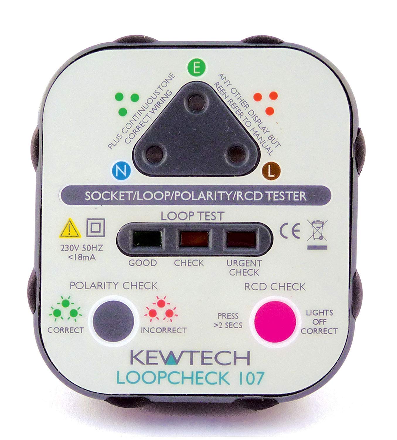

    Unless you do some thing daft, it does not LOOK too bad. However without using a meter you don't really know if there is an earth and if the RCD will trip, so does seem a good idea to test it, so you know it works.
    There is nothing dangerous about using a fuse instead of a MCB or having one RCD for all, however I would expect it is likely to trip, and with my own house I up graded the protection within 6 months of moving in.
    As to if you buy a tester like this [​IMG] or get an electrician is up to you, however the problem arises if the tester shows a fault, what will you do? Likely get an electrician, so maybe better to get an electrician to start with. Martindale also do one [​IMG] but looking at around £40 to £100 for tester which may be better spent getting an electrician. Since we have no idea how the RCD is wired it really does want testing with some thing other than its own test button.

    Those "testers" don't tell you nearly enough to know whether the RCD is operating within the parameters laid down in the Standard or not.
    Periodic inspection and testing is the answer.
