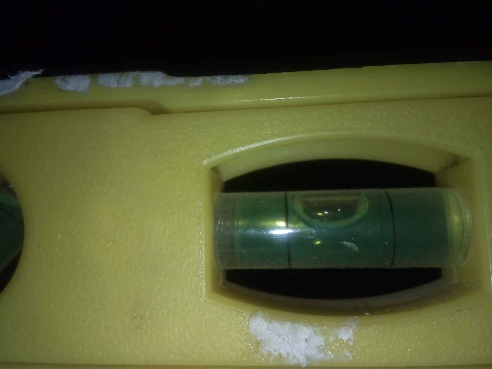

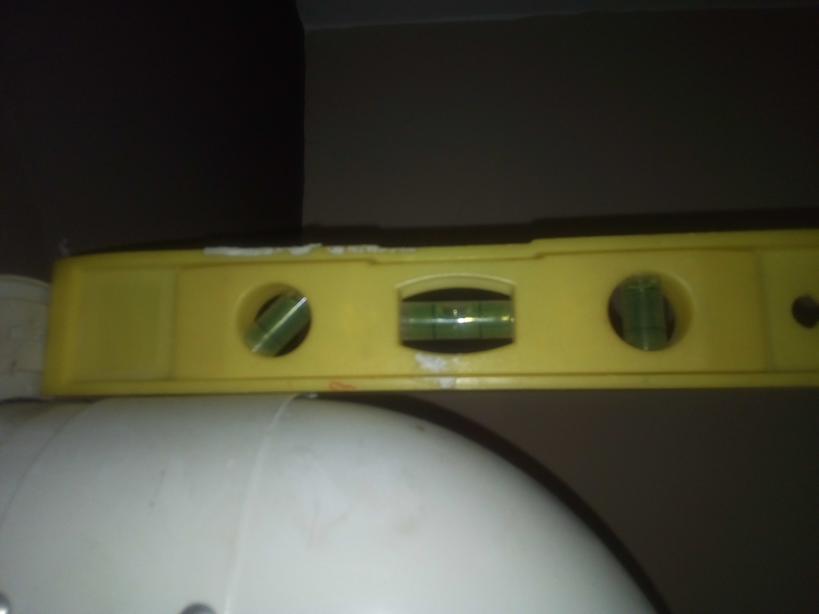

Its a Vaillant Ecotec Pro24, top flue exit, (I understand the pipe is angled to something around 89%) then straight through a wall and vents outside, no extension pieces it's about as short a run as could be. He was placing a level on the internal bracket and saying it was horizontal, so needed fixing? Claimed that the slight discolourisation on the rendered wall outside was a health hazard etc. It is hardly visible, and probably just 8 years worth of accumulation.

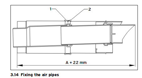

I took a look at the Vaillant flue installation instructions.
The air/flue pipes of the horizontal wall penetration are not concentric. With the wall penetration fitted horizontally, the flue pipe slopes downwards at 1.5° towards the inside.
Putting a spirit level on the internal flue pipe clamp shows bang on horizontal, however the internal flue outlet angles up at 1.5 degrees inside the flue pipe. There is apparently a flexible coupling inside, so the 3 degree rule may well be met. If the clamp is not perfectly square on the 87 degree elbow there will be an inaccurate reading.
