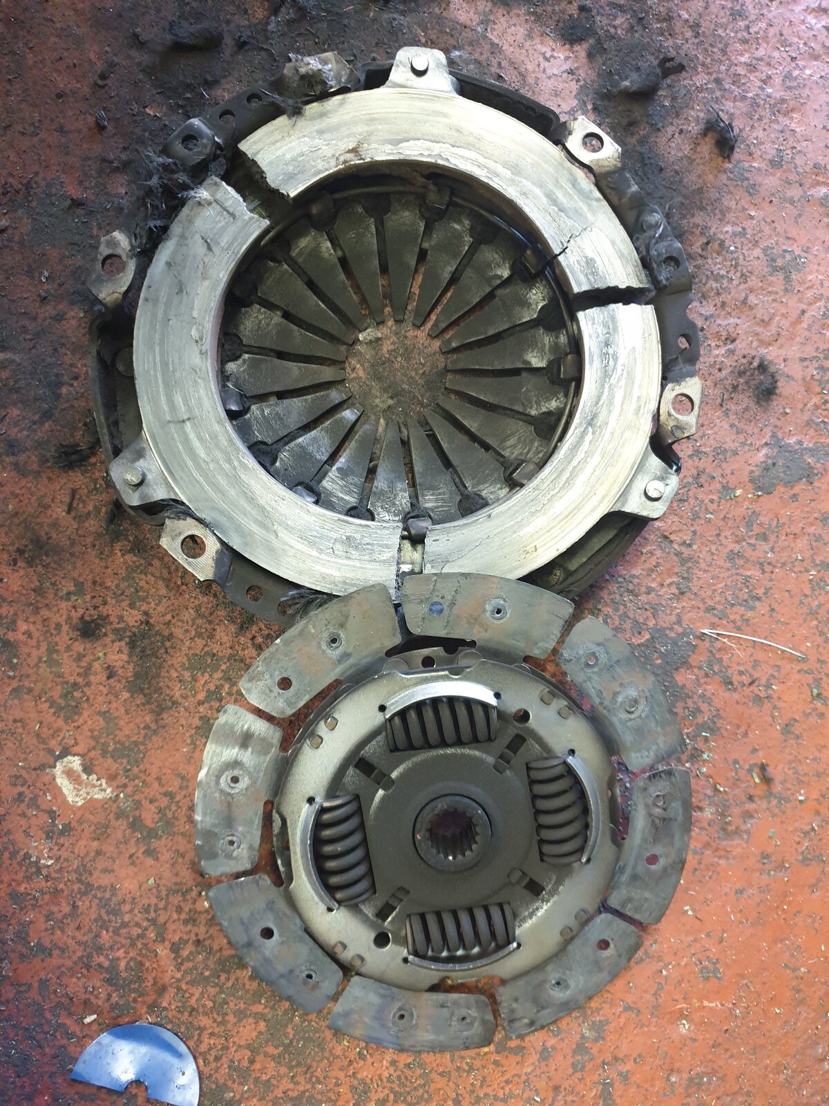

I took this clutch out of a customers car a couple of years ago. She hardly used the car. To be fair, she was almost deaf so she was in the habit of pulling away at 6000 rpm! She’s given up driving now.
Hmm. So much for one lady owner. Clutch looks like it's been attacked with an angle grinder then dropped from a height.
