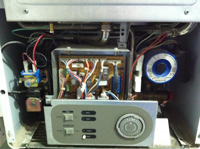

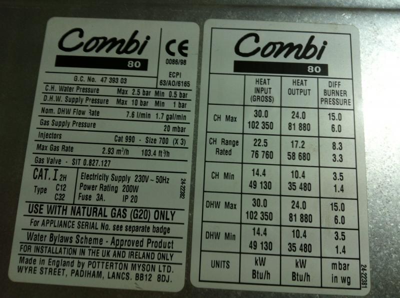

British Gas say we need a whole new boiler as you can't buy a heat exchanger for a Potterton Combi 80 any more.
They said there are none in the country.
However I have found second hand ones and whole second hand boilers for sale.
Is it worth getting a plumber to fit a second hand one?
We have a service contract so I'm wondering if that would be affected by the decision too.
Thanks in advance.
The exchanger sprung a leak - it's 9yrs old and the water spilt out over the electrical dials and blew the house trip switch so there could possibly be the panel to replace too maybe.
Thanks in advance.
