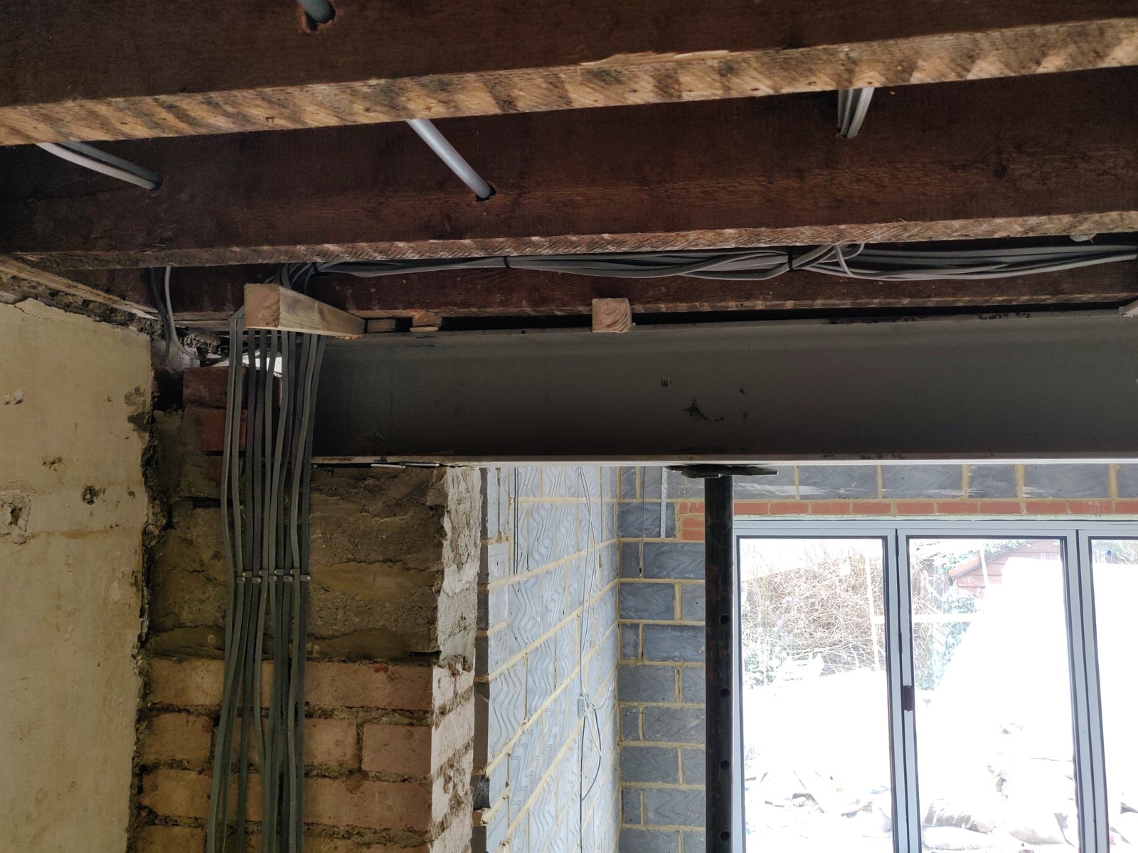

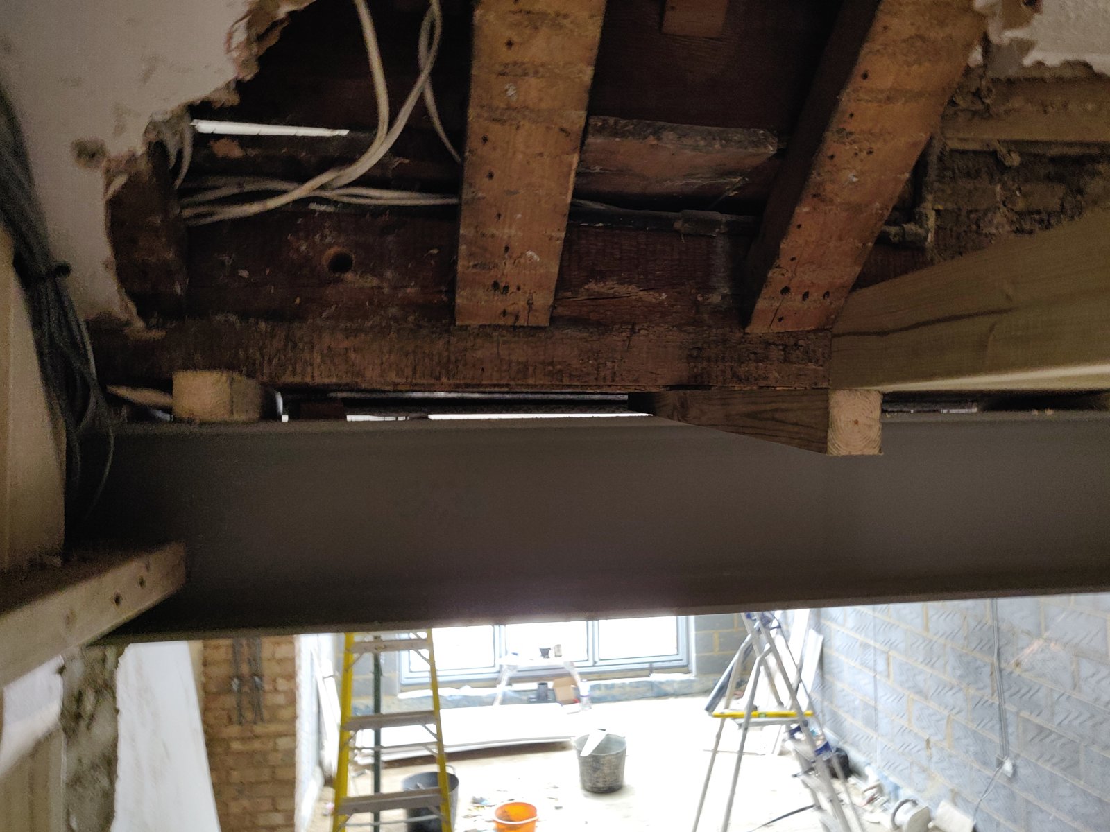

Hi guys, was wondering whether anyone could offer some advise regarding RSJs that our builder has installed.
The job was done at breakneck speed and as a result the RSJs weren't level which I challenged builder over. Subsequently, they've decided to try lowering them by 10mm to get them level. This has resulted in cracking and has left gaps between the RSJ and the timbers above. The builder has been packing these with wedges of wood to rectify a tilt I noticed on them too (again between the top of the RSJ and timber above). Today, he decided to use small steel shims to try and sort the tilts from below also.
My question is, in terms of above, what should he be doing to ensure no gap between the RSJs and the timbers? What should he be using?
He's created around about 5 cracks in the external walls with all the faffing around and internal cracks to newly finished plaster. Concerned about water ingress and house falling down because of the slapdash approach.
Please advise and thank you in advance.

Thanks for the response, both the RSJs I'm concerned about are holding up the main body of the house. Essentially, we've a Victorian house with the rear extension. Works undertaken were side return and addition to back. The two steels have the wait of the upper floors on them hence why, to me, sticking wedges of wood above the RSJs and between the timbers in not sufficient. The beams are essentially level now but it's the void above them that is worrying, especially when numerous cracks have appeared on the inner and out walls.
If I'm going to tell the builder what I want done, are you saying slates with a mortar mix packed in tight? He was saying something like he couldnt use mortar as was going between steel and timber and not brick.

He's used small steel spacers to even up the bottom but the gap between the steal and the timber above is probably around 15mm plus in spaces as what Noseall said regarding timber shrinkage seems to apply here.

The beam should not be tilted -I would suggest it wants to be pretty level across its width.
The RSJ should be fitted level, but 10mm out or so makes no difference structurally -generally a builder will set a beam dead level if its possible to do so because a level beam makes subsequent work easier. Im involved in a job where the builders cut a beam in half and joined it with cleats -all done properly but the beam now sags by about 30mm in the middle which is causing them no end of problems including having to counterbatten the whole ceiling
The timbers above can be packed with something that is fairly stiff, offcuts of plywood would be ok, or plastic glazing shims. whats important is that the end of each stud is fully packed down to the beam.

Hiya, yeah, timber with brick commencing on top of the timbers. So essentially, as long as he packs with something durable and strong enough, we should be good? Cheers.
This is what it currently looks like. As you can see, quite a wedge of a gap there.

Whats not level, the beam or the roof?
Any packing must be with dense material - normally natural slate, or clay tile.

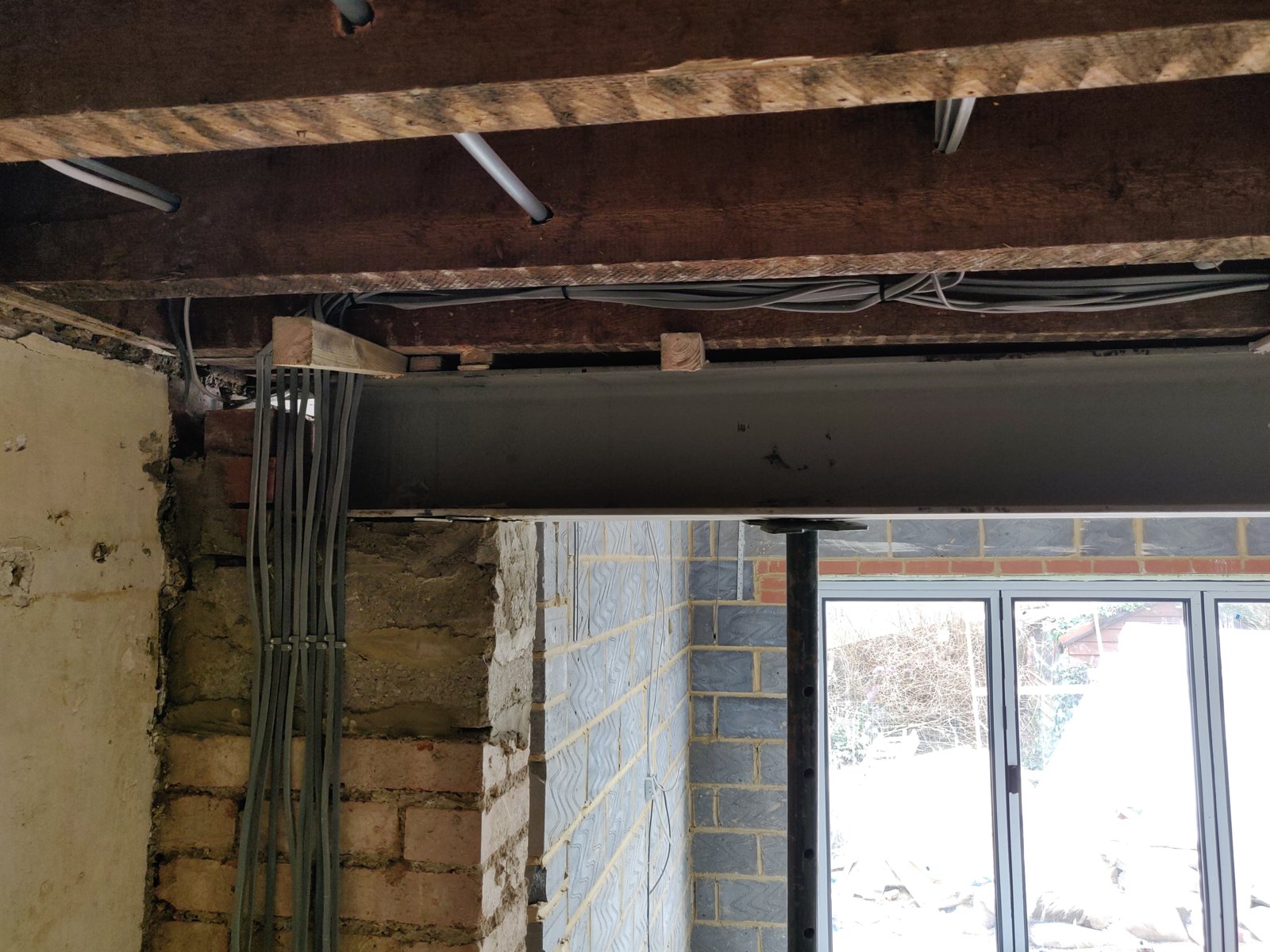

Nice cold bridge with the red bricks above the patio doors. (y)
And what the hell is going on with all those cables going down to just two light switches?

Thanks Woody, will ensure I speak to builder aboutaoqcking withwadequate materials. With regard to the red bricks, I'm presuming you mean about cold air meeting hot air? Walls around bifolds are packed with insulation, does this not remedy any bridging issues?
Regarding switches, the wiring is to enable control of the different light zones from multiple points.
