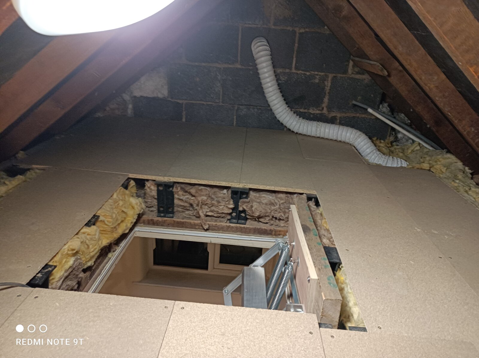

Should this flexible ducting not be rigid?
2 Sep 2016
10
I recently had a bathroom fan fitted with the flexible ducting going through the loft to the outside wall. From what I have read flexible ducting going through a cold space should be insulated to prevent condensation and lead to problems like legionnaires disease.
Having read further from what I can gather flexible ducting should be no longer than 300mm and clearly it is longer than this.
So should it be replaced with rigid ducting to meet building regs?
It looks like you might have a fan designed to go in a wall or window, trying vent a long exhaust. It really needs to be a more powerful inline fan, otherwise it simply wont clear the exhaust through the duct and you'll get water pooling in the pipe. You need something like this:
