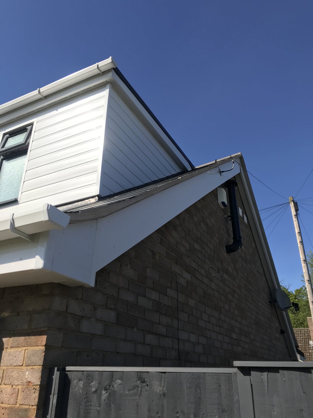

This is the vent outside.
Is this acceptable?
Looks fine to me, i haven't got a tape measure to check exact compliance, but in many ways out the wall is safer than making unnecessary holes in the roof coverings
Nowt wrong with that, as long as it's above the level of the appliances, and doesn't pong the house or loft out, it's fine. Looks a tidy job.
