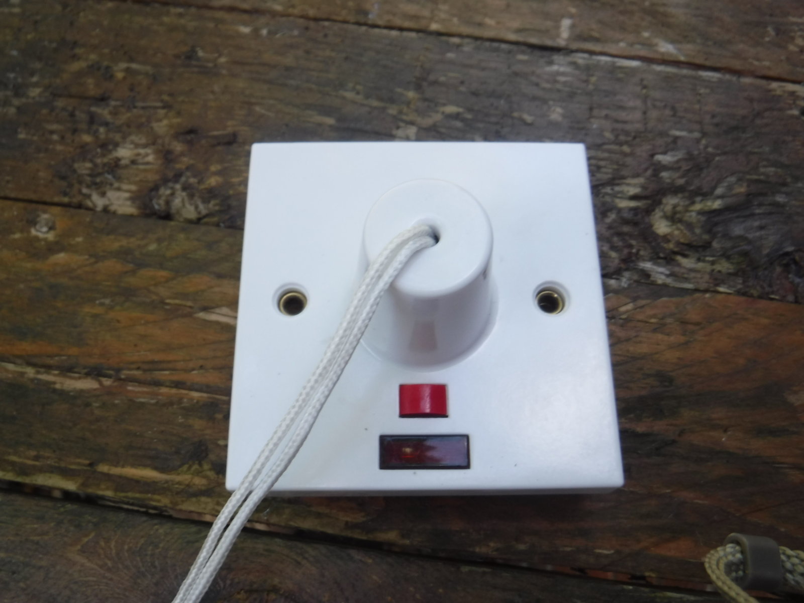

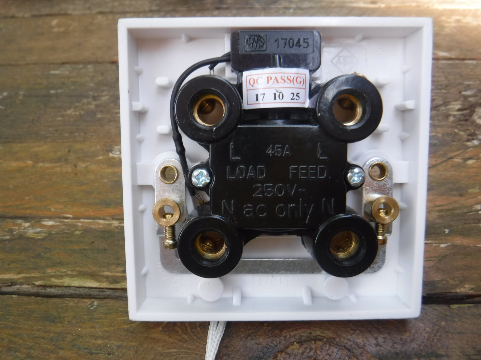

Thanks for such a quick reply. Here are pics of the new switch. The old switch is virtually identical.

the switch looks OK though I don't see the brand.
Do you think it could be mechanical friction? Does it sound like it clicks correctly, and the red indicator flag snaps into place?

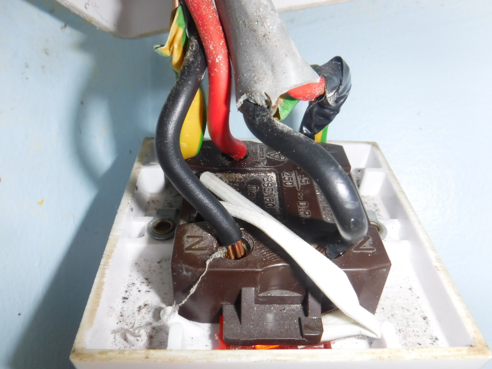

Here's a pic of it wired in. The feed is on the right of the picture and the shower is on the left.
By the way - there is no sign of burnining on the original switch.
that's the old switch, isn't it? it looks quite dirty.
It looks like it might be the old switch. The new one is different.
I have had an issue with some switches, both plate and pull cord where they are cheaply constructed and if the conductors go too far in to the terminal, they obstruct the switching mechanism. Crazy but true. Trimming them shorter relieves the issue.
You're right - it's the old switch. I had put it back in as the new wasnt making any difference. They both look the same though. I'll try shortening the wires that go in. Thanks.
Thanks Securespark, that has done the trick. I have no idea WHY it worked as I cant see any way in which the length of the conductors could obstruct the switch, but I just pulled one (the shower live wire) out about a mm and the switch is working fine now.
