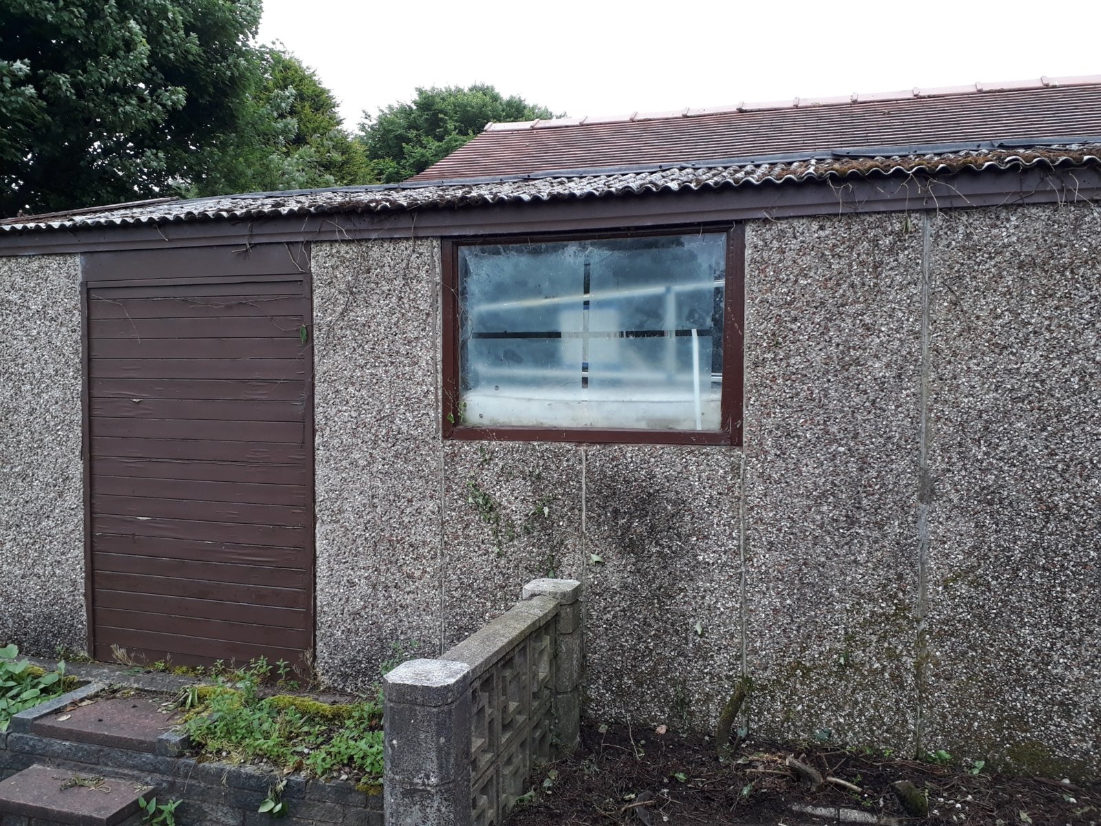

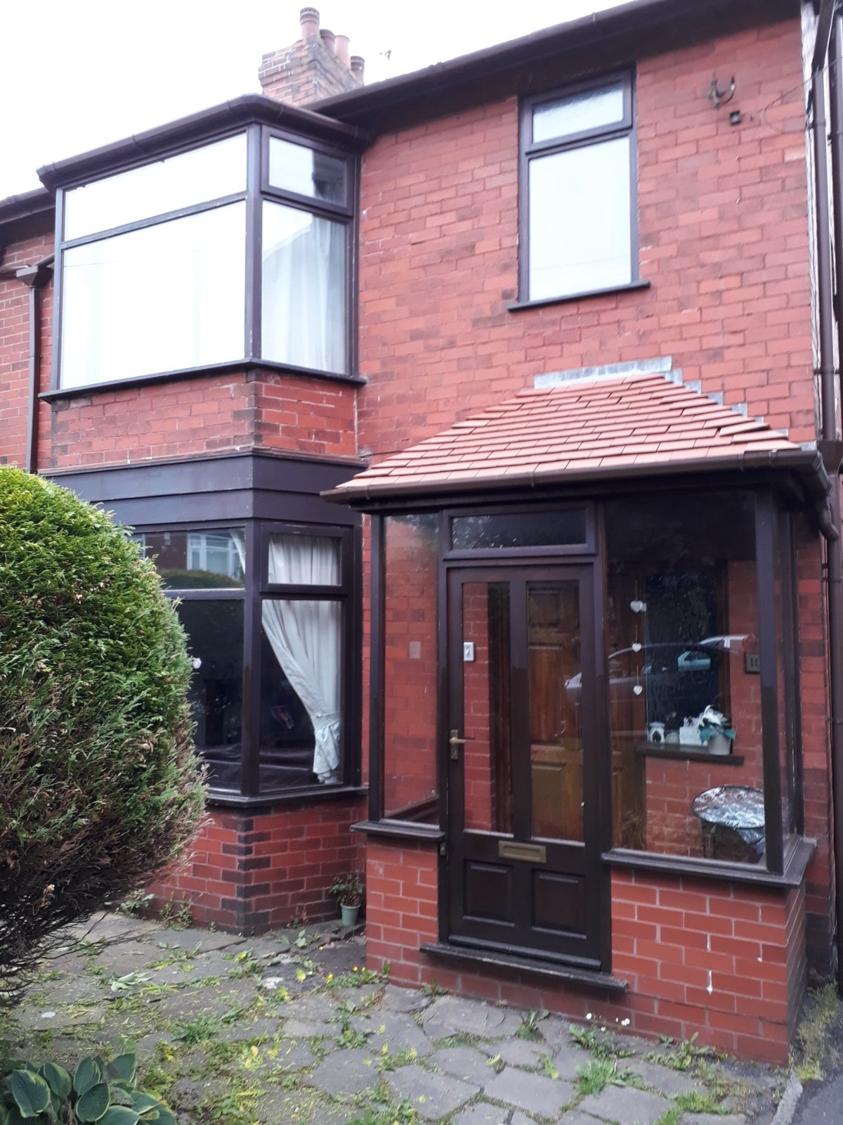

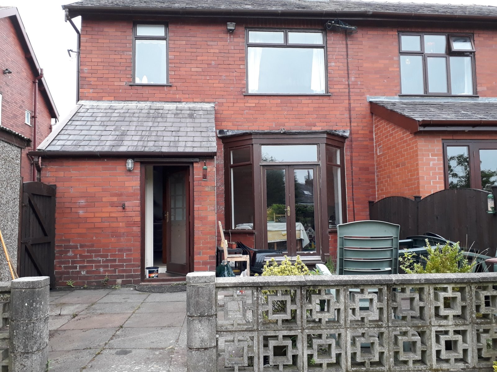

I have some timber window frames on my house. To the front of the property the windows look like they are hardwood and currently have a Ronseal exterior woodstain on them. To the rear of the property the frames appear to have a painted gloss finish (not sure if the frames are hardwood or softwood in case it matters but look more like softwood)

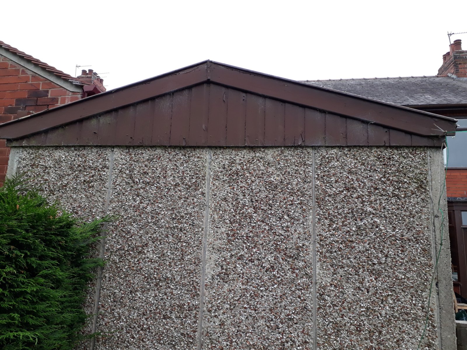

I also have timber cladding and fascia boards to a concrete garage that also currently has a painted finish. Again not sure what type of wood it is but looks like softwood which feels moist beneath the paint where its peeling off.
All the above are in need of painting again and appear to have some minor rot but I'm not sure which product is best for the type of wood/joinery that I've explained to protect against the elements mostly rot due to rain.
Sikkens have two products, sikkens cetol filter 7 plus and sikkens cetol thb plus. Dulux have the exterior weather shield quickdry satin finish.
On the type of joinery I've explained which type of finish would be preferable e.g. a stain like sikkens or a paint like dulux weathershield for maximum protection?
What preparation would be required to apply the coatings you recommend considering the coatings that are currently on the wood?
Someone suggested I should be using a stain since paint peels off so I'm a bit confused now.

The dulux quickdry like the Ronseal is water based and does not last long outside especially on horizontal surfaces like the sills.
I would go for Sikkens , expensive but well worth it.
How do I prepare the surfaces. Do I sand them all back both the ronseal stained side and the painted gloss side? Do I need to apply a base coat when using sikkens?
Don't sand back the gloss it will take flakes off and never look right, use a fine sandpaper (wet and dry) and just take the shine off it.

Some of the gloss is peeling off?
IMO, normal oil based 'trade' gloss will last longer and go on better than the water based dulux
For any bits where the paint's peeling, give it a going over with an scraper, and ideally primer on bare wood
You can scrape off any old peeling paint; if it is really bad use a heat gun or paint stripper, back to the bare wood, but both these methods require great care.
