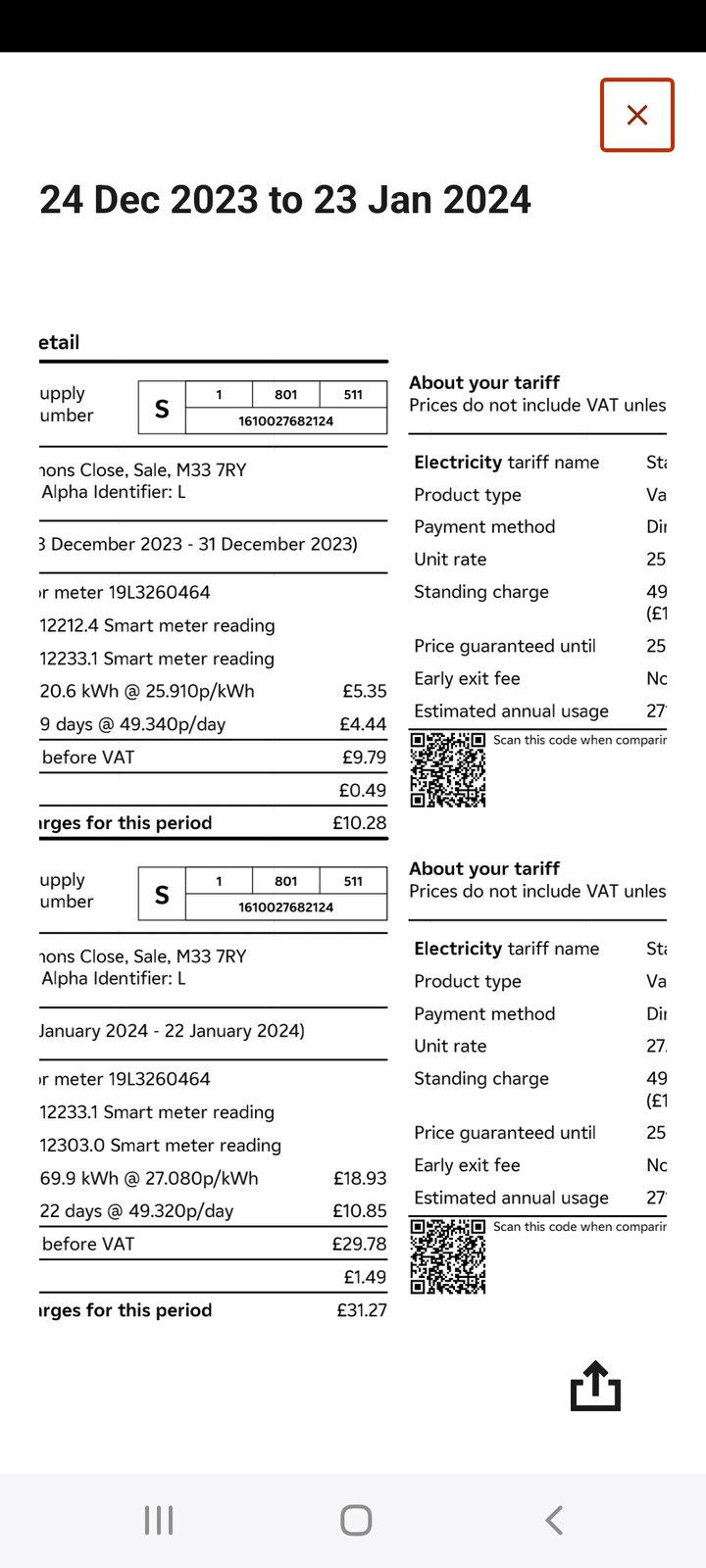

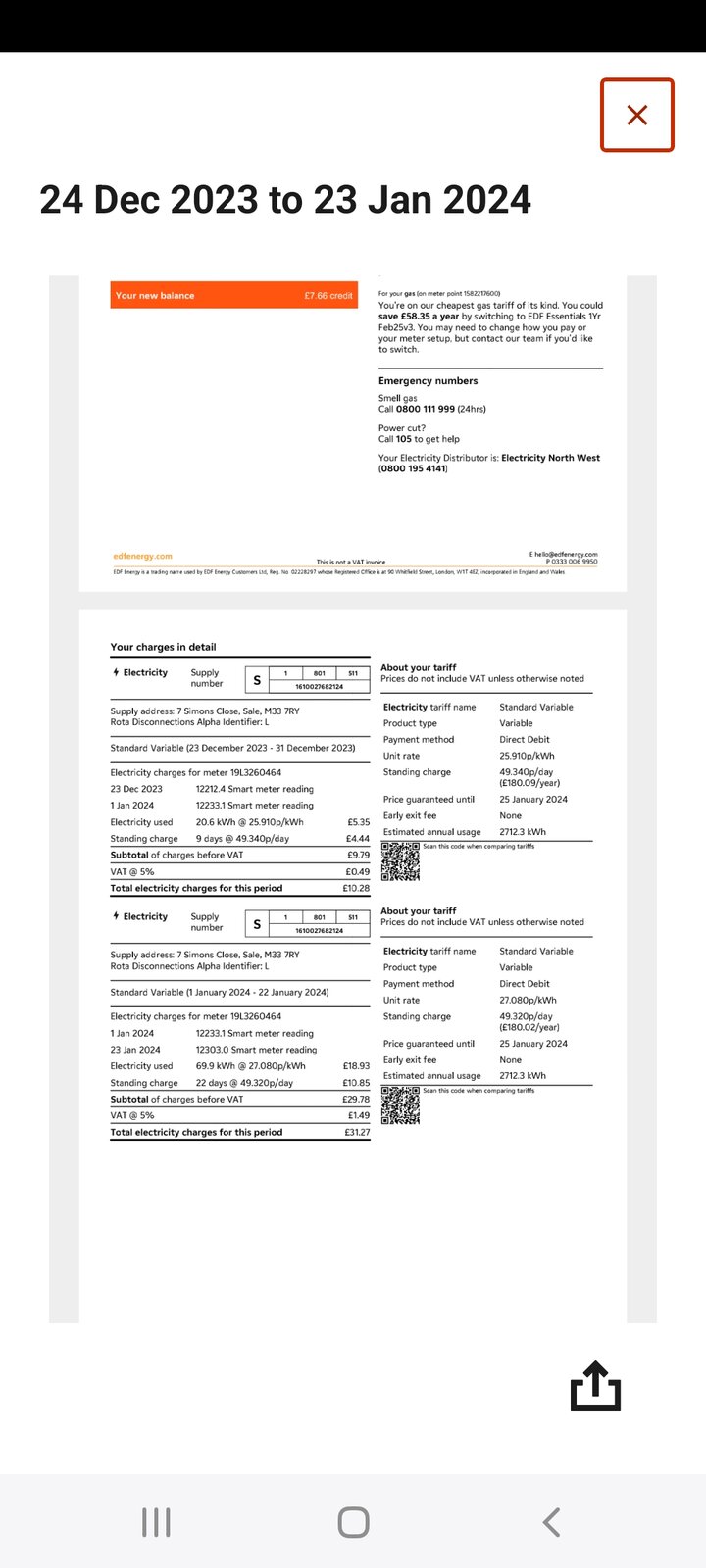

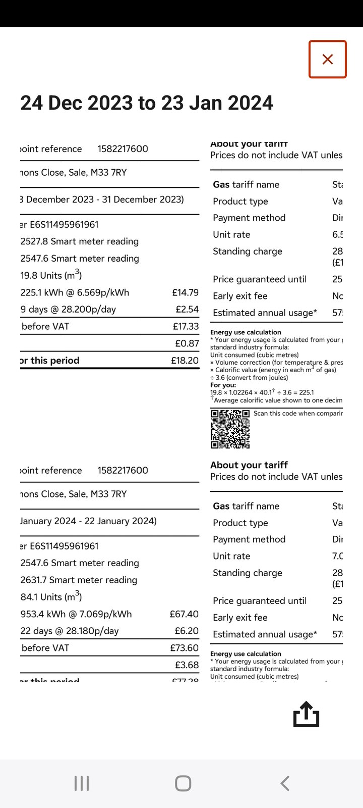

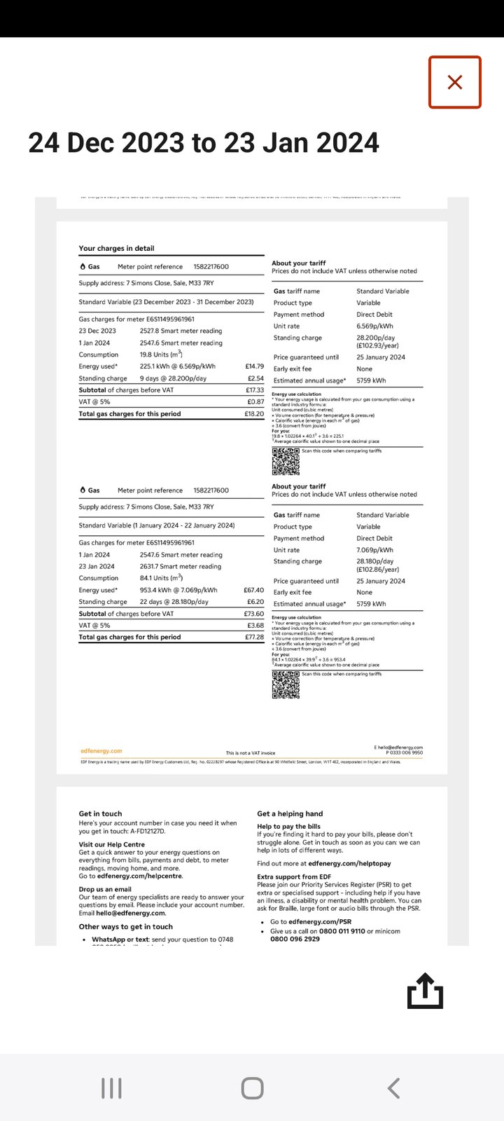

So then I've Analysed your relevant Bill
23-31 Dec
Electric 20.6 units @ 25.91pence per unit Average of 2.29 units per day
Gas 225.1 units @ 6.569pence per unit Average of 25.01 units per day
1-22 Jan
Electric 69.9 units @ 27.08pence per unit Average of 3.2 units per day
Gas 953.4 units @ 7.069pence per unit Average of 43.34 units per day
From January onwards the Gas consumption almost doubled, sorry but that is what the bill is showing.
