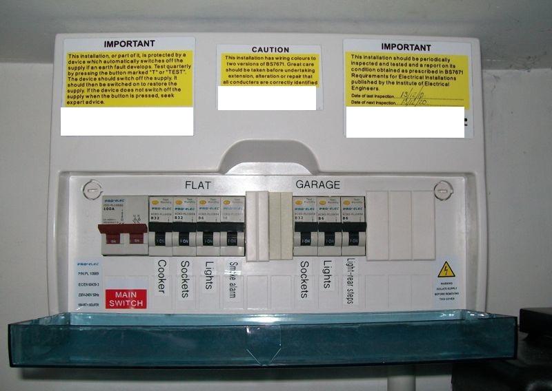

While we're having an "I'll show you mine" session :LOL:
What do I score out of 10 for this one ? Personally I wasn't that happy with it - but as others have pointed out, there's not that much room, and it's hampered by being a replacement which restricts both cable entry locations and lengths.
Nice Neat work - isn't it great when you have that much space to work in, especially with RCBO's compared to the fiddly, cramped Consumer units currently on the market.
Yep you don't see many pictures of fully populated CU with RCBOS.
While we're having an "I'll show you mine" session :LOL: What do I score out of 10 for this one ? Personally I wasn't that happy with it - but as others have pointed out, there's not that much room, and it's hampered by being a replacement which restricts both cable entry locations and lengths.
For what little my opinion is worth in this regard, I'd say that the neatness of that wiring is approaching the best that one can reasonably expect to achieve in a standard domestic CU, particularly when it's full of RCBOs. I would not be all all unhappy if that had been my work.
I might ask if the conductors are labelled (I can't see any labelling in photo).
Kind Regards, John.
