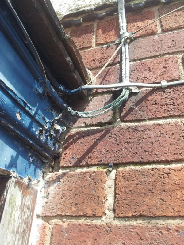

I just had WPD come and do a service renewal for me at a property I was renovating for a friend. The old overheads had no insulation left where they were attached to the walls.
Anyway, they installed a new meter box with cutout on the outside of the property. Then Haste came to do the wire back and move the meter.
They installed a switch fuse in the meter box and then 3 core SWA to the CU.
The SWA armour is not earthed. At either end they placed a jacket over the cores and heat shrunk it down.

Interesting pic.
Have you a picture of the switch fuse they installed by any chance?
Are you sure it is SWA?, the distribution network operators tend to use concentric or split concentric cables, as seen in the original pic, the DNOs stuff is tiny in comparison to what the OP installed!
