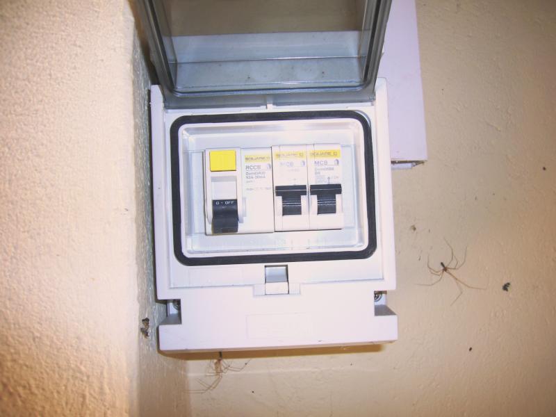

    Good morning!
    all connections seem ok.
    Thinking about removing RCD unit.
    The garage has its own mini consumer unit:
    and the garage itself is protected by the main consumer unit in the house:
    If I take out the RCD above the failing socket in the garage,
    and fill the gap with a suitable junction box, will this be ok?

    There is no need to have the RCD/FCU unit as you already have RCD protection at the garage consumer unit (check the RCCB is rated at 30mA).
    Don't quite get the reasoning behind this connection unit being in place other than loading restrictions on continued circuit.
    Unless you have a faulty RCCB in the mini CU.
    I assume it is the 40A MCB for distribution to garage?
    • Thanks Thanks x 1

    Yes, as you say.
    Anyway - the RCD has now gone and everything is now working!! :)
    Thanks so much to everyone who has helped!

    Have you checked the cables inside the RCD/FCU on both the load and supply sides and the new socket to see that they make full contact with the terminals - sounds like you may have pinched wire - with the terminal trapping the conductor insulation.

    What rating is the MCB that's protecting that socket/summer house?
    There is a slight chance that the RCD/FCU was being used to fuse down the circuit it was protecting.

    From the picture of your house CU, it looks as if it's at least possible that the 40A MCB supplying the garage may not be RCD protected. Are you sure that is it? If it weren't, and you have now removed the RCD from the garaage CU, that would obviously mean that your garage now has no RCD protection at all!

    I think the 40A MCB is for the cooker circuit or something 'up'.
    The garage circuit appears to be on a 20A (right hand MCB) and protected by the RCD.
