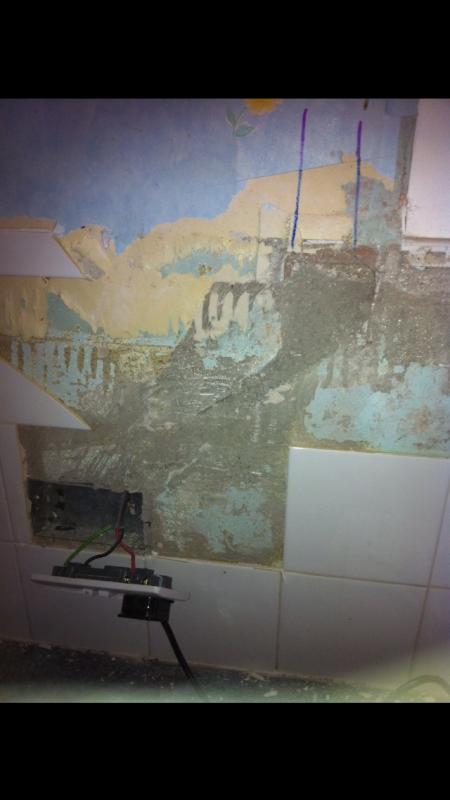

Sockets in Kitchen moved after installed too low

I think the only answer is to cut out all the work and redo. Having so many joints and little extensions to the wiring is just scrappy, whether it's compliant or not.

The first picture has 3 incoming cables (Excluding the ones to the newly position socket), so a taped over joint of that size definitely doesn't look appropriate!
Hi, we have had electrics installed into a new extension by a qualified electrician
too low at 970mm and needed to be moved up to 1150mm,
A good example of the difference between 'qualified' with bits of meaningless paper, and someone who actually knows what they are doing.
Kitchen worktops have been at a height of around 900mm for ever.
No one with any sense would install kitchen sockets at 970mm, unless there was some very specific reason such as special low height cabinets or similar.
It's all well and good covering the joints up if you're not bothered about having a non compliant installation and the risks this poses, but I've wrecked several kitchens trying to find joints like this which have been covered over and subsequently failed.
Get it put right properly now while you have the opportunity, or regret it in a few years time when your beautiful new kitchen is ruined in the process of restoring your power.
Thanks to each and everyone of you, unfortunately you have confirmed my fears and will need to talk to the builder to get the work re done.
the cabling was installed by the electrician and its the electrician that will be issuing a Part-P for the work, this is were i got worried as i really didn't think it was compliant, i know the cables have been joined, crimped and taped but it just didn't "feel" right, as the new boxes now have no relation to the cable run as they ran horizontally to the boxes, the height issue was between the Electrician and the builder so its their issue. Unfortunately covering with blanking plates is not an option as they will be half covered with the upstand.

Get him to re-do it, by running most of the cables under or behind the base units, and no buried joints.
I can see what he's tried to do. He's been informed it's wrong, and done it that way to make less damage.
But it would have been just as easy to re-do it properly, or at least compliantly.
