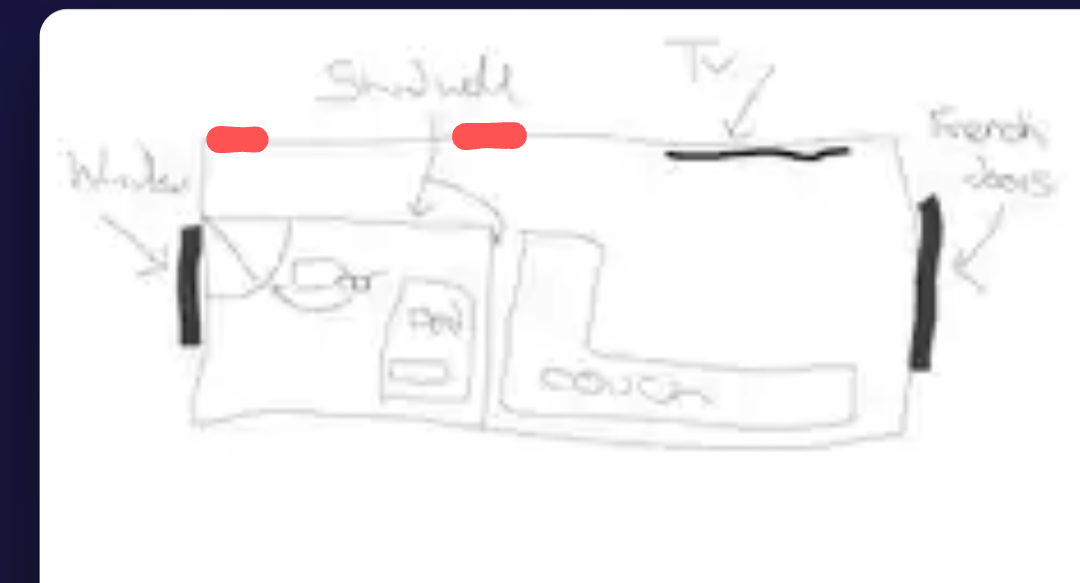

As said by other posters, mass is your friend. Doubled up (dense) plasterboards with the joints staggered is a good idea. As is sealing the B'jesus out of every gap you can see, around the wall/floor/ceiling abutment. Skimming the lot is essential.Thanks for your advice
But you (hopefully ) didn’t sleep there with a TV going next door?When we had an office partitioned off in work a few years ago, the architect specified two layers of plasterboard on one side only with rock wool in between the studs. Worked very well.

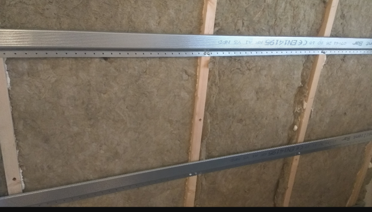

This is a pretty reasonable set-up, definitely use the sealant around the perimeters of all boards edges, anywhere, consider the using resilient bars too on any walls if you don't intend on fixing anything to the walls though that takes more space, you could use 48mm metal studs but 70mm studs would increase sound resistance but take away further space, adding an acoustic strip to a fire door would help too. Important boring bit, the room musty have it's own means of escape, otherwise you'll not be complying with Building Regs (which you should also apply for as the work is notifiable), your house insurance would be invalid and you risk the life of anyone staying in the room (kids often sleep through smoke alarms):From a building regs point of view, you are fine as it has a window (Assuming you can get out of it) and access to other easy alternate routes out.
I would use metal studs, double plasterboard with Rockwool RWA45 or similar sound insulation. It shouldn't be full fill, it should be about or just over half, and be against 1 of the sides. The mixture of different densities is what reduces the airbourne noise. You can get acoustic sealant for around the perimeter of the plasterboard, but I've never tried it so can't rate it.
You would also need to keep the door quite tight to the floor to stop sound transmission that way.
They just lead to the hall
Yes, it has a windowit should really have ventilation does it have a window or ventilation
The small red blob closest to the window in the current door location, which leads into the hall. We were thinking of re-locating the the door (bigger of the red blobs), but that is a main supporting wall, and the kitchen is directly behind that, so if we moved the door there, we would loose space in the kitchen.What I meant, obviously without seeing the rest of the layout, is it a door that could be relocated?
