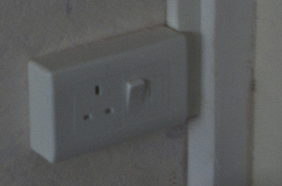

I used a double back box with a 4 module grid plate with a socket, switch and fuse in the plate, so all was through a 13 amp fuse. IMGP7387c.jpg I used LAP from Screwfix, but there are other makes.
I used a double back box with a 4 module grid plate with a socket, switch and fuse in the plate, so all was through a 13 amp fuse. View attachment 307171 I used LAP from Screwfix, but there are other makes.
Got a link to this - I don’t seem to be able to find it.
Would be perfect does what I need allowing me to run the spur and saves me hard wiring the fridge in! Thank you!
Edit: ah I found the bits thank you - will look into doing something similar!
