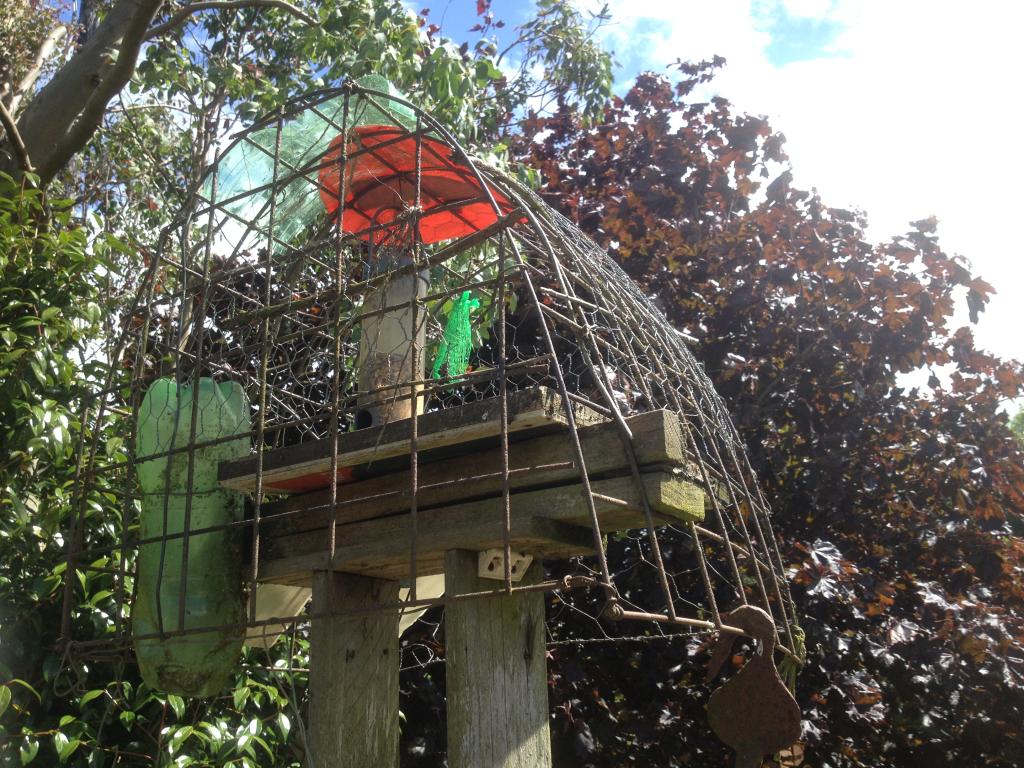

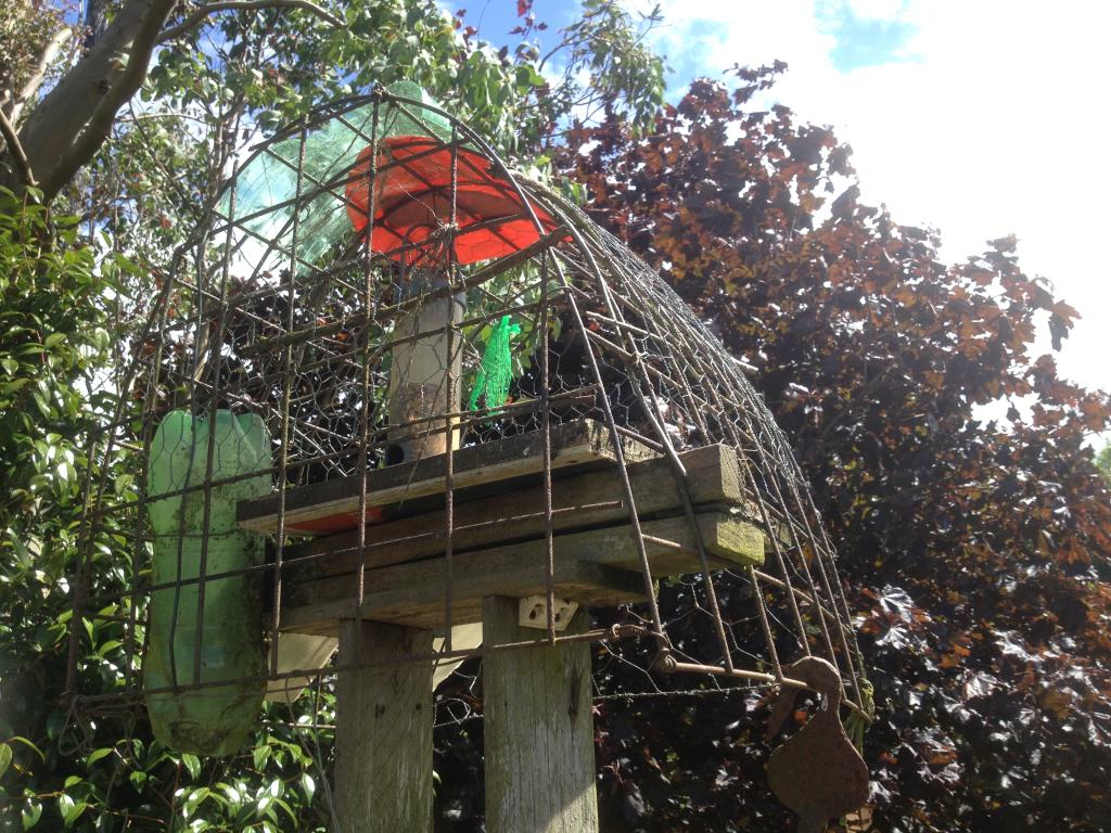

I used welded mesh covered with 1.4" netting wire. I covered the top with a piece of plastic bottle to stop them reaching in and pulling food towards them. Food needs to be in the centre and out of arms reach. I also covered the supporting stake with split large bottles to make the stake too smooth for a grip. It took nearly a month of refinement before I got the better of them.
