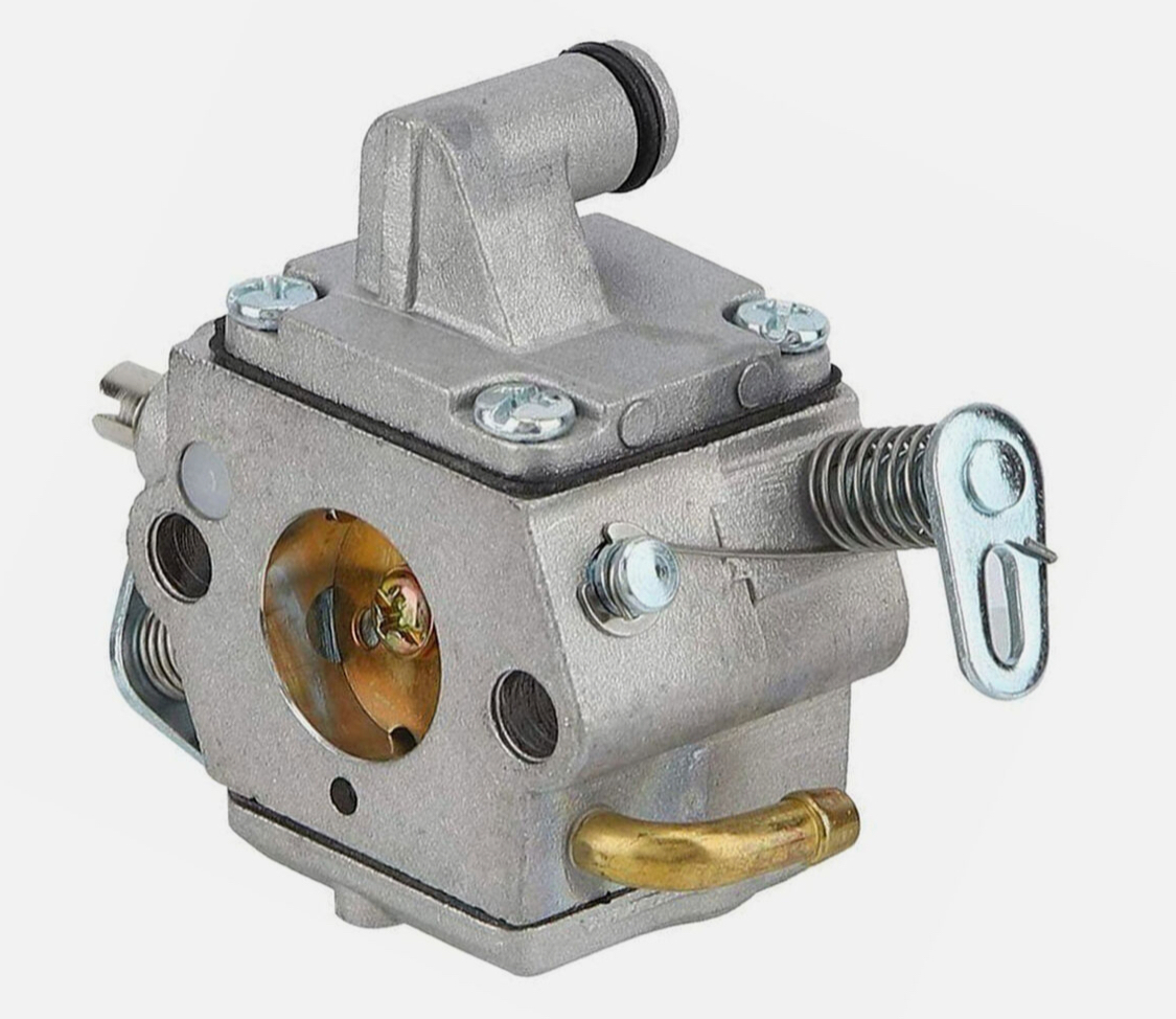

I’ve ordered another carb & plug

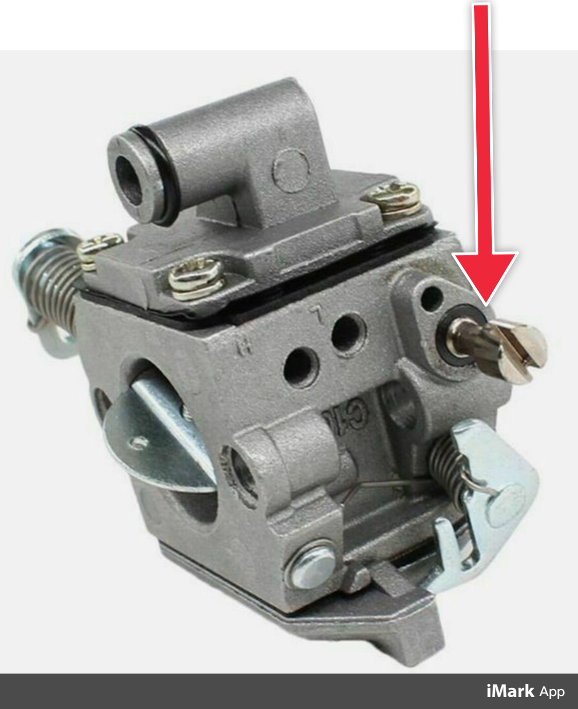

I remember now......no H and L screws, just one chrome idle speed screw on the side.
There are two diaphragms and gaskets, one top, one at the bottom, metering and pump.
If you want to open it up again, check the very fine gauze filter that is on the opposite side to the needle valve.
replacement carbs are readily available for less than £20 - I'd certainly go for one.
John :)
Here’s the carb Ive ordered & looks the same as mine
Is the tick over screw your mention the one arrowed.
