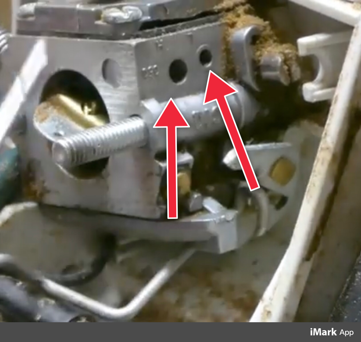

Still MS170 chainsaw hard to start & doesn’t run long
Just looking at a video and see H and L on his also but they must be blanked off.
Now need to go check mine again.

So many carburettor variations - some have mixture screws, some don't.
This is a very popular carb with the smaller Stihl chainsaws so plenty replacements are available.
John :)
Ive taken mine apart again & i now do see the holes BUT they are not threaded, So never a jet fitted just a hole & it looks like either a small brass fitting with a hole or just a blank at the bottom.
Ive taken carb apart again & cleaned it but pretty much clean.
I took the chain side cover off & was covered in fine sawdust / bar oil so cleaned it up.
I think i might of nudged the poor design filter a touch when putting on the top cover as when i did this yesterday i made sure it was spotless but this morning i could see a small amount of sawdust in that black plastic part which holds the car to the engine.
Yet to start it but will do very soon
